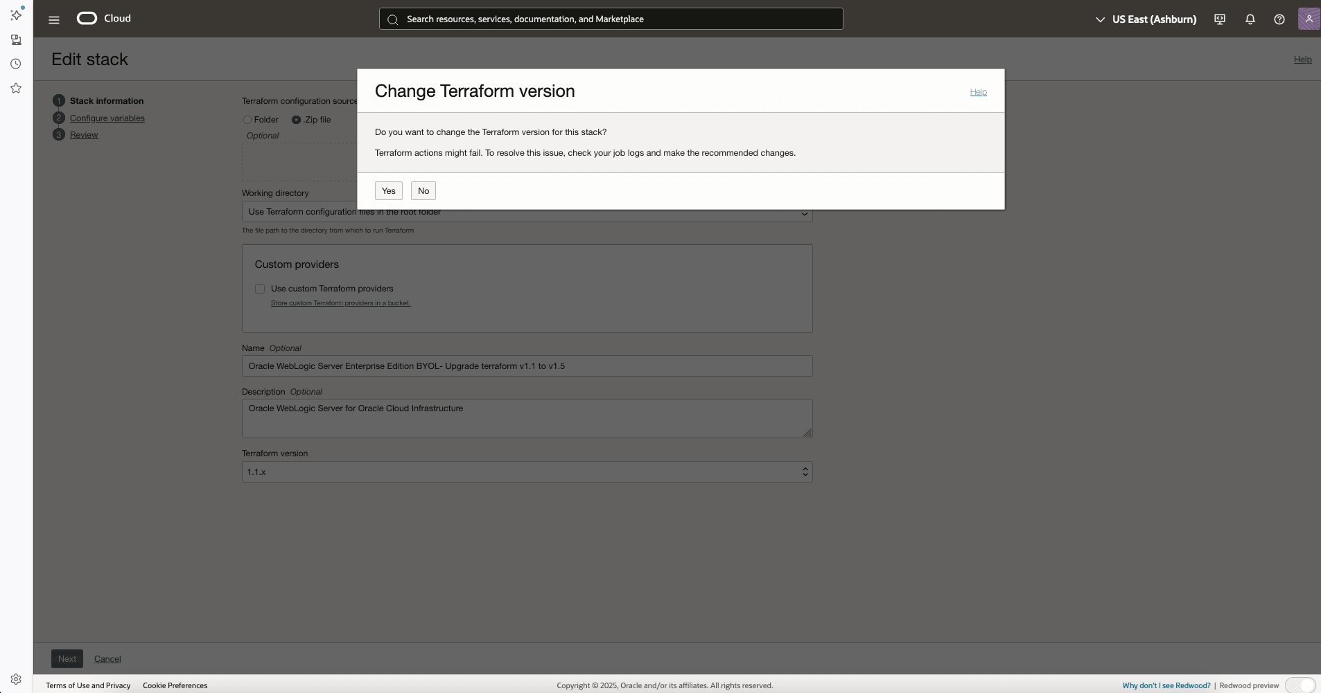

  4. Change the Terraform version to 1.5.x. Click Yes to confirm the change.
    Figure D-1 Terraform target version
    target version

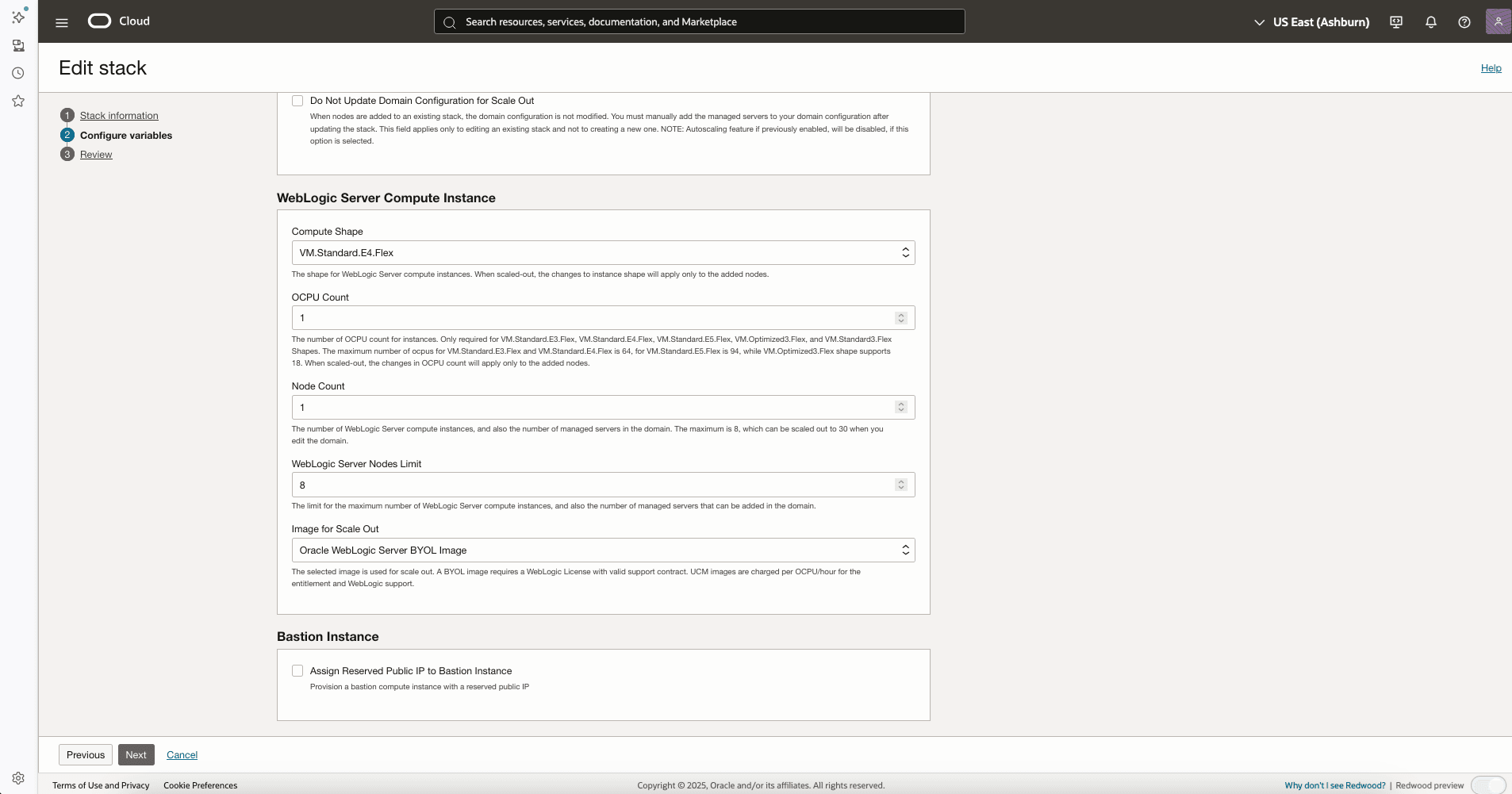

    1. Select Next. This will bring you to the Configure variables panel.
    2. Review the options selected to make sure that they correspond to the options you want the Stack to have.
      There is a known issue where the "Use Resource Manager Endpoint" may be selected even if you deselected this option during Stack creation. Unselect this option before proceeding.

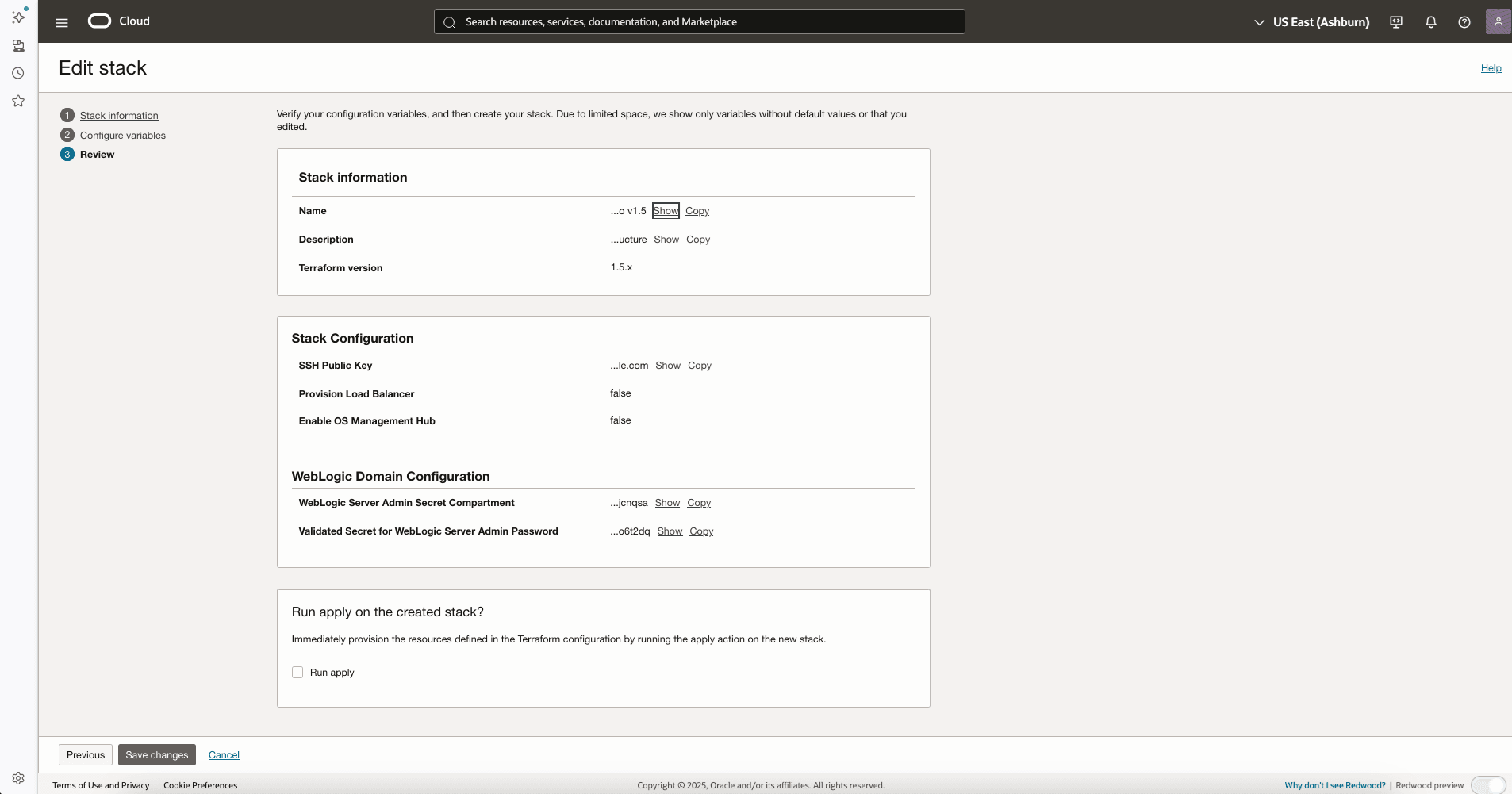

    3. Select Next. This will bring you to the Review panel.
    4. Review the variables, paying particular attention to the "Terraform version" value which should now be 1.5.x.
    5. Select Save Changes.
    Figure D-2 Save changes
    verify that the changes are saved
    Figure D-3 Save and exit
    save and exit the screen
The stack is now synchronized with the upgraded Terraform configuration and specified Terraform version. You can now proceed to the next task for importing the state file.

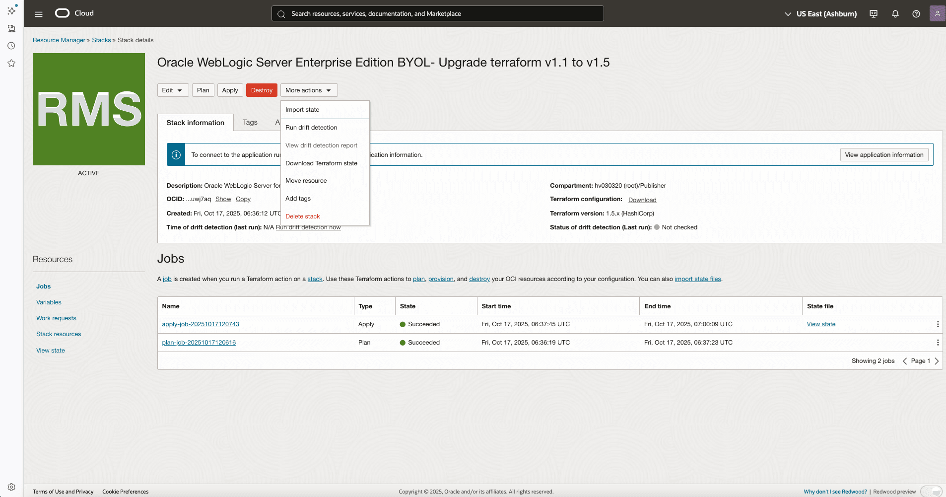

  1. In the Console, reopen the details page for the stack that you're upgrading: On the Stacks list page, select the stack that you want to work with. If you need help finding the list page or the stack, see Listing Stacks.
  2. Go to More actions and select Import state.

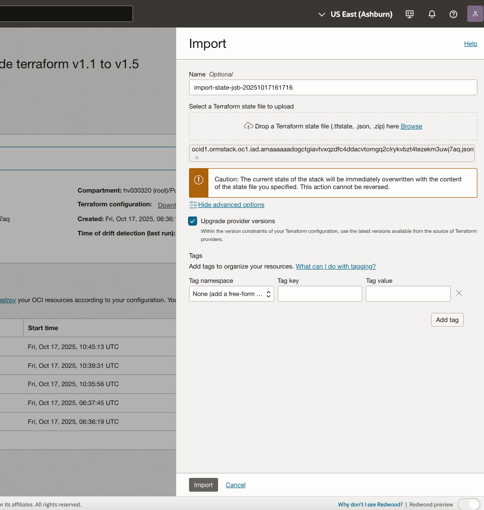

  3. In the Import panel, add the downloaded Terraform state file from Step 1-4.
    You can either drag the file onto the dialog's control or select Browse and navigate to the location of the file or folder.
    Figure D-5 Import state file
    import state file; add downloaded file
  4. Select Show advanced options.
  5. Select the checkbox for "Upgrade provider versions" and select Import.
    The import job is created. The new job is listed under Jobs. When the job finishes, the Job details page opens.

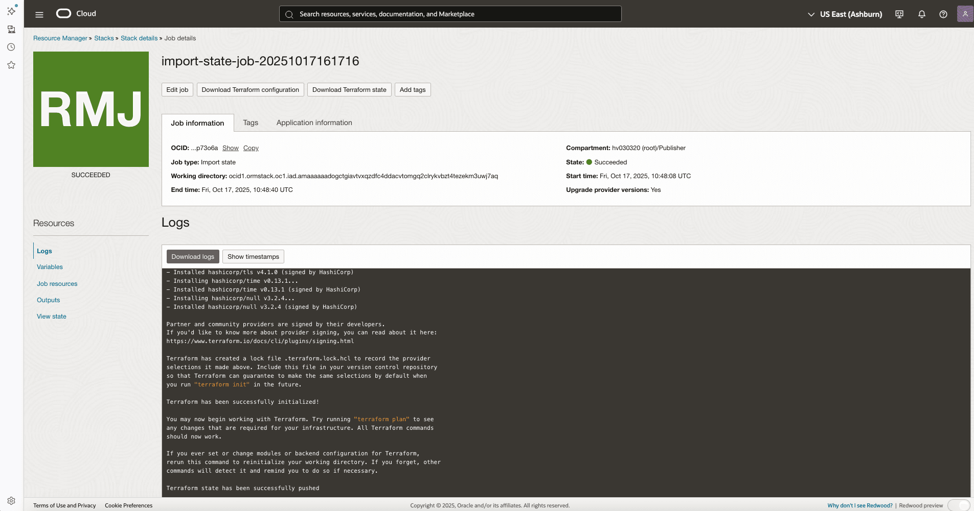

  6. Confirm successful import: Select Logs.
    Figure D-6 Confirm import
    confirm import of state file
After a successful import of the state file, proceed to the next task for checking for issues.

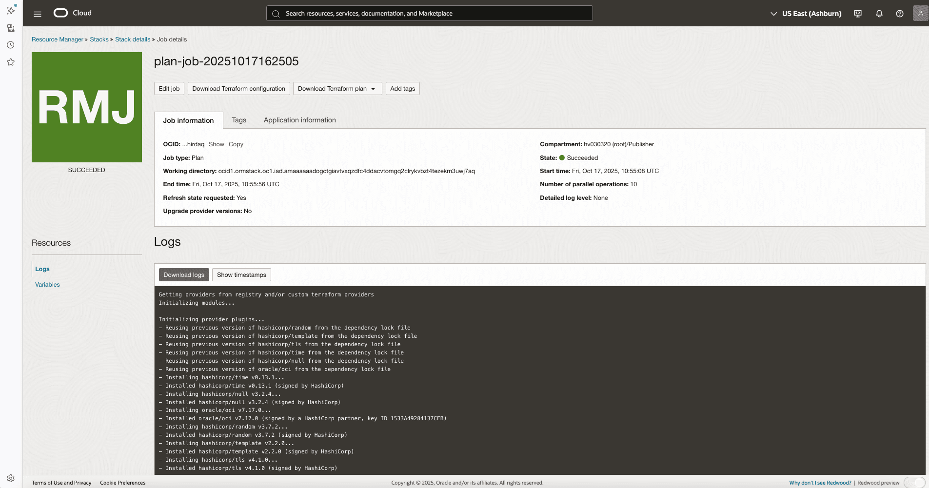

  2. Check for pending changes to infrastructure:
    1. Select Plan.
      Figure D-7 Validate import
      validate the import action
      When the action finishes, the details page for the related job opens.
    2. To review the log for the completed plan action, select Logs.
    3. In the log contents, check for issues described at Troubleshooting Logs During an Upgrade.
  3. Resolve any listed issues by manually updating the Terraform configuration, as described at Troubleshooting Logs During an Upgrade.
