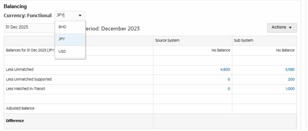

The Balancing panel shows a balance summary for the reconciliation at that point in time, as of the date selected. As a best practice, the unexplained difference (or just difference if the match type is an Account Analysis) should be 0.00 once the period ends and related open adjustments have been posted as journals back to the source system. Click any total (Less Unmatched, Less Unmatched Supported, or Less Unmatched In-transit) to drill-down and view the transactions for that total. When you configure currency for data sources within the match type, the Currency drop-down is displayed. Select a currency to display the balance summary for the selected currency in the reconciliation.
This image shows the Balancing panel, with the Currency option.
