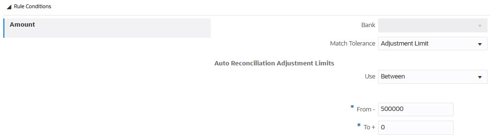

  5. Now enter your rule condition. Note that in an Adjustment rule type, you only have one rule condition since unlike other rules, you are not comparing one source to another. Therefore you cannot create another rule condition.
    Adjustment rule type - rule conditions
    Optionally, you can add Adjustment Limits if you need to restrict the auto match to a range. For example, a value between -2000 and +2000. There is no limit if the From and To values are blank.
