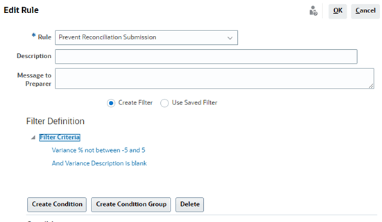

Example: Calculate Period Variance and Require an Explanation
The Service Administrator wants Preparers to enter an explanation when the variance between periods fluctuates over a specified percentage.
This example creates a custom attribute of type Number and a calculated attribute that computes the variance between two periods. Although this example uses Variance Analysis, the values can also be interchanged for Account Analysis methods.
Create a calculated attribute Variance % with the following settings:
  • Type: Number
  • Total: None
  • Calculation Type: Scripted
  • Select Display to User
  • Calculation Definition: (TRANSLATE({Source System Balance (Functional)}, 'USD', 'Accounting') - TRANSLATE({Variance Period Balance (Functional)}, 'USD', 'Accounting'))/TRANSLATE({Source System Balance (Functional)}, 'USD', 'Accounting')
Next, create a custom attribute named Variance Description with Type set to Text.
Create a rule using both the calculated attribute and the text attribute. In the Filter Definition, set the filter criteria as shown in the following screenshot.
Example of using attributes with a rule to enforce variance explanation.
