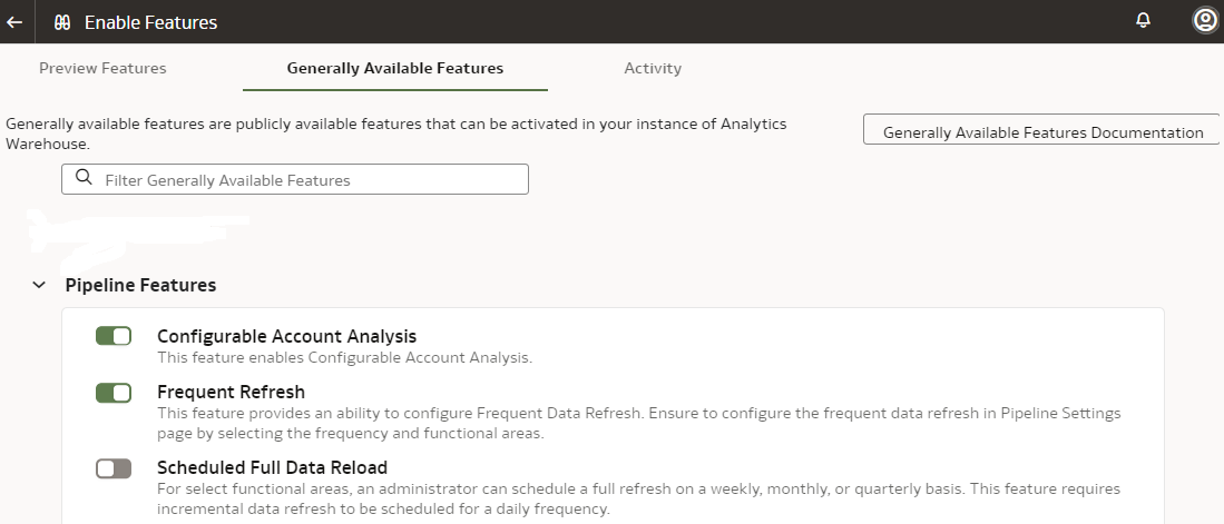

  1. Sign in to your service as a functional administrator.
  2. In Oracle Fusion Data Intelligence Console, click Enable Features, and then click Generally Available Features.
  3. Under the Generally Available Features tab, select the toggle to enable Configurable Account Analysis.

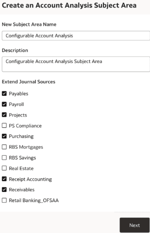

  4. In Create an Account Analysis Subject Area, in New Subject Area Name, enter a name for the subject area such as Configurable Account Analysis and provide a brief explanation in Description.
    Avoid using prebuilt subject area names like "Financials - GL Account Analysis" as it isn't supported.
    Create an account analysis subject area dialog
  5. Under Extend Journal Source, select the journal sources like Payables, Receivables, Project Accounting, Assets, Cost Accounting, as applicable and then click Next.

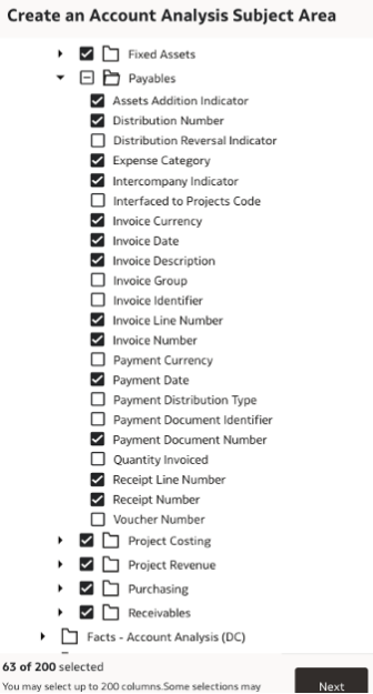

  6. From the list of attributes available in the template, select the required attributes for reporting and click Next.
    Select attributes for reporting

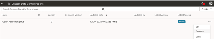

  6. Is there an option to turn off the CAA feature already in use?
    To turn off the CAA feature, use the Delete option available on the CAA template setup. This removes the CAA data extracts and CAA subject area definitions. The related visualizations would error out and you must manually delete them. On the Enable Features page, under the Generally Available Features tab, disable Configurable Account Analysis.

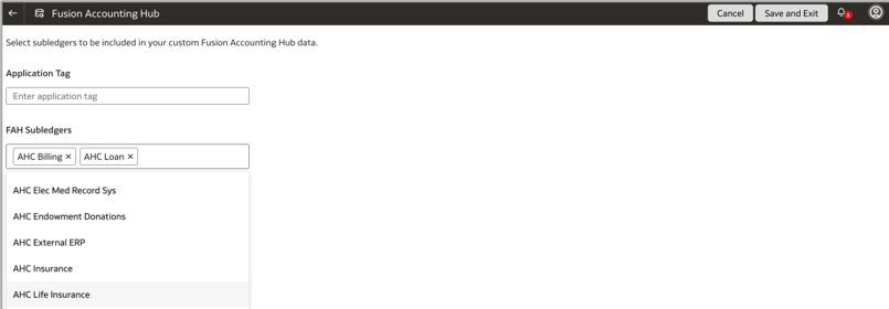

As a functional administrator, configure Fusion Accounting Hub Analytics by specifying the Accounting Hub subledger applications that need to be available for analytics.
While configuring, you can see the accounting applications set up in the Fusion Accounting Hub source. Ensure that you select only the accounting hub applications set up in the Oracle Fusion Cloud Applications source with Supporting References and Journal Entry Rule Set assignment complete.
  2. In Oracle Fusion Data Intelligence Console, click Data Configurations, and then click Custom Data Configurations.
  3. Select Create and then select Fusion Accounting Hub.
    Create and Fusion Accounting Hub options on Custom Data Configurations page
  4. On the Fusion Accounting Hub page, in Application Tag, enter a unique identifier for the application definition and then select the Accounting Hub subledger applications that need to be available for analytics.
  5. Click Save and Exit to create the application definition with “Inactive” status.
  6. On the Custom Data Configurations page, for the Fusion Accounting Hub configuration, click the Actions icon, and then click Edit to modify the Accounting Hub subledgers selection.
    Edit option
  7. From the action options, click Generate to deploy the application definition that would submit the background processes.
  8. After the Generate action is complete, select Deploy from the action options to create the Fusion Accounting Hub application related subject areas.

    3. Toggle off the Fusion Accounting Hub feature under the Preview Features tab on the Enable Features page.
