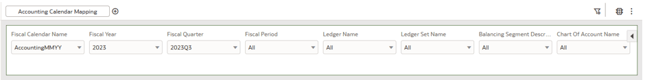

Role-playing Parameters

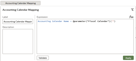

Usually a filter affects only one column, but in the case of role-playing parameters the filter effectively "impersonates" multiple columns. In some cases an Overview Dashboard is built so that the values selected in a single dashboard filter can be propagated to more than one subject area column. This works best if each of these columns has the same set of values. For this use case, a Workbook Filter is used to map multiple columns to a parameter. For example, in this case the “Accounting Calendar Name” columns will be populated by the “Fiscal Calendar” parameter. As mentioned in the "Parameter Binding" section, the “Fiscal Calendar” parameter also populates “Fiscal Calendar Name.” Using this dashboard filter would update both columns. Here's the Workbook Filter where the mapping is specified:
Using a Workbook Filter to write this expression

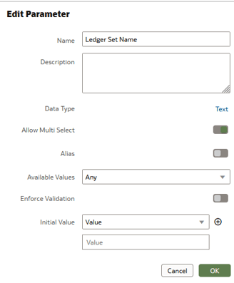

Use Parameters in Detail Dashboards
You can duplicate the parameters from an Overview Dashboard and use them as a channel to pass context between the workbooks.
Ensure that you use the same parameter name and data type while duplicating. Also, ensure that the data action specifies the parameters that should be included in the context.
Pinning Parameters to Dashboard Filters
To maintain the value of a dashboard filter across canvases within a workbook, you can use the parameters to replicate a “pinning” behavior seen in Workbook Filters. In essence, the “pinning” behavior creates an empty parameter and then each of the dashboard filters use "Parameter Binding" to shuttle that value across the dashboard filters on multiple canvases.
An empty parameter
