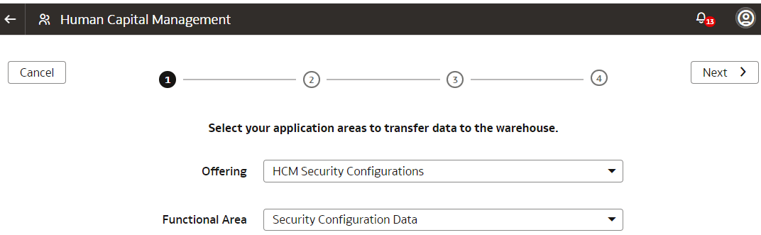

Can I bring additional data security-related objects from Oracle Fusion Cloud Applications into Fusion Data Intelligence to set up custom data security in Fusion Data Intelligence?
On the Console, under Applications, in Human Capital Management, when you create a pipeline for the Security Configuration Data functional area in the HCM Security Configurations offering, Fusion Data Intelligence gets additional data from Oracle Fusion Cloud Applications (Cloud HCM). You can set up custom data security leveraging this new data.

- Sign in to your service.
- In Fusion Data Intelligence, click the Navigator.
- In the Navigator menu, click Console.
- On the Console, click Data Configuration under Application Administration.
- On the Data Configuration page, click Human Capital Management.
- On the service page, click Create, select
HCM Security Configurations in
Offering, select Security
Configuration Data in Functional
Area, and then click Next.
- Review the parameters and click one of the options:
- Cancel: To cancel the data pipeline for the functional area.
- Save: To save the data pipeline for the functional area but not activate it.
- Activate: To schedule when to run the data pipeline for the functional area. See Activate a Data Pipeline for a Functional Area.
