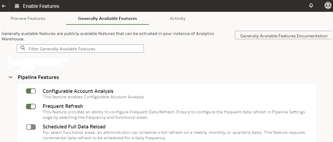

  1. Sign in to your service as a functional administrator.
  2. In Oracle Fusion Data Intelligence Console, click Enable Features, and then click Generally Available Features.
  3. Under the Generally Available Features tab, select the toggle to enable Configurable Account Analysis.
    Configurable Account Analysis option under Generally Available Features tab on Enable Features page

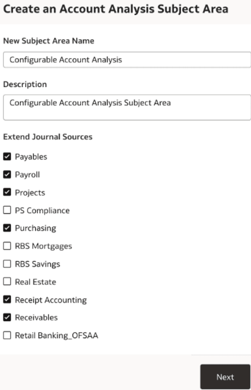

  4. In Create an Account Analysis Subject Area, in New Subject Area Name, enter a name for the subject area such as Configurable Account Analysis and provide a brief explanation in Description.
    Avoid using prebuilt subject area names like "Financials - GL Account Analysis" as it isn't supported.
    Create an account analysis subject area dialog
  5. Under Extend Journal Source, select the journal sources like Payables, Receivables, Project Accounting, Assets, Cost Accounting, as applicable and then click Next.

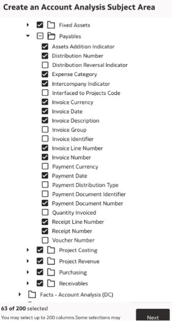

  6. From the list of attributes available in the template, select the required attributes for reporting and click Next.
    Select attributes for reporting

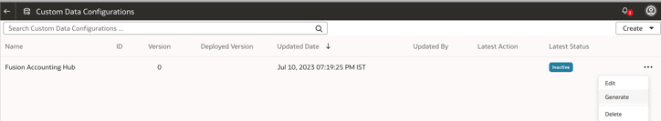

  5. To reset or deactivate a CAA application, click Data Configurations on the Console, click Custom Data Configurations, and then click the Reset or Deactivate option for the applicable CAA application.

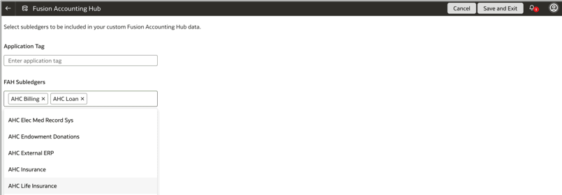

Fusion Accounting Hub Analytics
Fusion Accounting Hub Analytics empowers finance organizations to establish a comprehensive system of insights for accounting data. It's an add on SKU to Oracle Fusion ERP Analytics.
Accounting Hub Analytics enables you to discover meaningful correlations among balances, journals, and granular sub-ledger transaction details and supporting references. These correlations enable you to swiftly detect irregularities with end-to-end traceability.
Intelligent data pipelines source data from Oracle Fusion Accounting Hub, enabling automatic configuration of pipelines, data models, and analytics views. This data is drawn from Oracle Accounting Hub sub-ledger applications, enabling organizations to gain valuable insights from both operational and financial data.
Special Considerations
  • Transaction data availability in Oracle Fusion Data Intelligence is governed by the data retention policies of the Fusion Accounting Hub. The Accounting Hub Maintenance process in Fusion automatically purges processed transactions after the configured retention period. Therefore, only transactions retained in Fusion at the time of data extraction will be available in Oracle Fusion Data Intelligence For details on Accounting Hub data retention, see Accounting Hub Maintenance.

As a functional administrator, configure Fusion Accounting Hub Analytics by specifying the Accounting Hub subledger applications that need to be available for analytics.
While configuring, you can see the accounting applications set up in the Fusion Accounting Hub source. Ensure that you select only the accounting hub applications set up in the Oracle Fusion Cloud Applications source with Supporting References and Journal Entry Rule Set assignment complete.
  2. In Oracle Fusion Data Intelligence Console, click Data Configurations, and then click Custom Data Configurations.
  3. Select Create and then select Fusion Accounting Hub.
    Create and Fusion Accounting Hub options on Custom Data Configurations page
  4. On the Fusion Accounting Hub page, in Application Tag, enter a unique identifier for the application definition and then select the Accounting Hub subledger applications that need to be available for analytics.
  5. Click Save and Exit to create the application definition with “Inactive” status.
  6. On the Custom Data Configurations page, for the Fusion Accounting Hub configuration, click the Actions icon, and then click Edit to modify the Accounting Hub subledgers selection.
    Edit option
  7. From the action options, click Generate to deploy the application definition that would submit the background processes.
  8. After the Generate action is complete, select Deploy from the action options to create the Fusion Accounting Hub application related subject areas.
