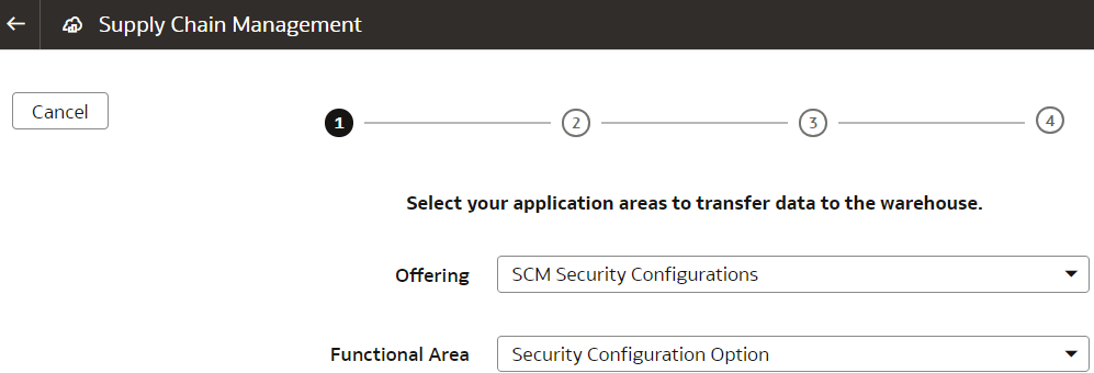

To synchronize data security, you must create a pipeline for the "Security Configuration Option" functional area in the "SCM Security Configurations" offering. This pipeline enables Fusion Data Intelligence to extract the user security assignment details from Oracle Fusion Cloud Applications (Cloud SCM) and load it into Fusion Data Intelligence. Based on the user configuration in Oracle Fusion Cloud Applications (Cloud SCM), the synchronization process assigns the inventory organization, cost organization, manufacturing organization, requisition business unit, and procurement business unit (PO Agent) values to the users in Fusion Data Intelligence.
To ensure that synchronization happens frequently, you must schedule the incremental refreshes. See Set Up the Pipeline Parameters.
- Sign in to your service.
- In Fusion Data Intelligence, click the Navigator.
- In the Navigator menu, click Console.
- On the Console, click Data Configuration under Application Administration.
- On the Data Configuration page, click Supply Chain Management.
- On the service page, click Create, select
SCM Security Configurations in
Offering, select Security
Configuration Option in Functional
Area, and then click Next.
- Review the parameters and click one of the options:
- Cancel: To cancel the data pipeline for the functional area.
- Save: To save the data pipeline for the functional area but not activate it.
- Activate: To schedule when to run the data pipeline for the functional area. See Activate a Data Pipeline for a Functional Area.
