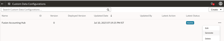

  6. On the Custom Data Configurations page, for the Fusion Accounting Hub configuration, click the Actions icon, and then click Edit to modify the Accounting Hub subledgers selection.
    Edit option
  7. From the action options, click Generate to deploy the application definition that would submit the background processes.
  8. After the Generate action is complete, select Deploy from the action options to create the Fusion Accounting Hub application related subject areas.
