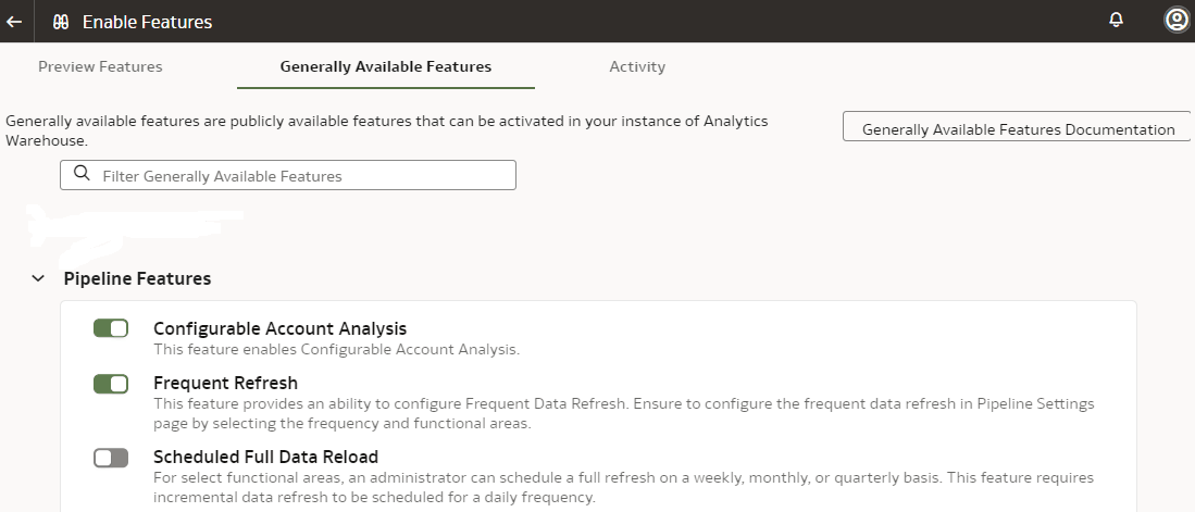

  1. Sign in to your service as a functional administrator.
  2. In Oracle Fusion Data Intelligence Console, click Enable Features, and then click Generally Available Features.
  3. Under the Generally Available Features tab, select the toggle to enable Configurable Account Analysis.
    Configurable Account Analysis option under Generally Available Features tab on Enable Features page

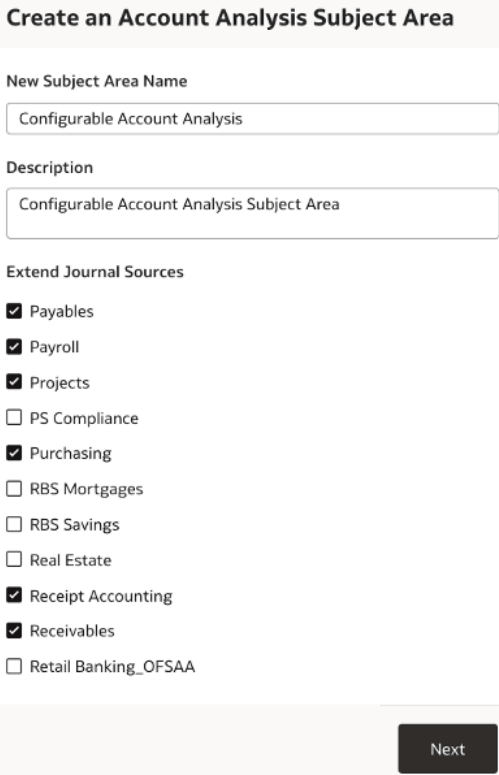

  4. In Create an Account Analysis Subject Area, in New Subject Area Name, enter a name for the subject area such as Configurable Account Analysis and provide a brief explanation in Description.
    Avoid using prebuilt subject area names like "Financials - GL Account Analysis" as it isn't supported.
    Create an account analysis subject area dialog
  5. Under Extend Journal Source, select the journal sources like Payables, Receivables, Project Accounting, Assets, Cost Accounting, as applicable and then click Next.

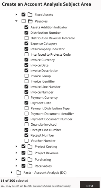

  6. From the list of attributes available in the template, select the required attributes for reporting and click Next.
    Select attributes for reporting
