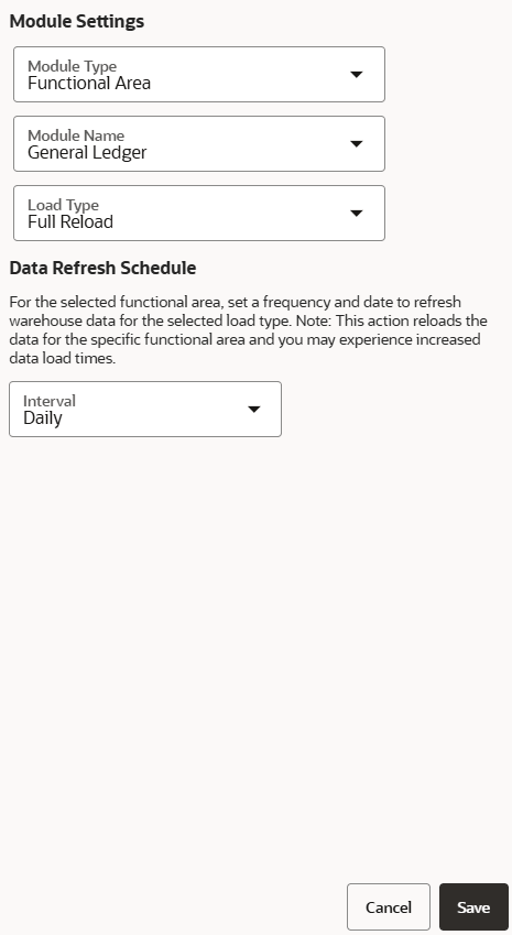

  5. Click Add to specify the refresh schedule and load type for either a functional area or custom data configuration.
  6. In Module Settings, select either Functional Area or Custom Data Configurations in Module Type, select the applicable name in Module Name, and Full Reload as Load Type.
    Module Settings dialog
  7. In the Data Refresh Schedule section in Module Settings, select the frequency interval such as daily, weekly, monthly, quarterly, or yearly.
  8. Based on the selected frequency interval, select the specific day of the week, month, a day in the first month of the quarter, or a month and day of the year.
  9. Click Save.
