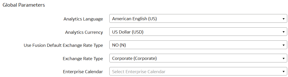

  6. Under Global Parameters, provide these details:
    1. From the Analytics Language list, select the language in which you want to extract the data.
    2. From the Analytics Currency list, select the currency of the transaction data.
    3. In Use Fusion Default Exchange Rate Type, specify whether you want to use the default exchange rate type from Oracle Fusion Cloud Applications.
    4. From the Exchange Rate Type list, select an exchange rate type that you want to use when converting the transaction amounts to the global currency.
    5. From the Enterprise Calendar, select a fiscal calendar to configure the reporting calendar used in Oracle Fusion Data Intelligence.
    Global parameters on the Pipeline Settings page
