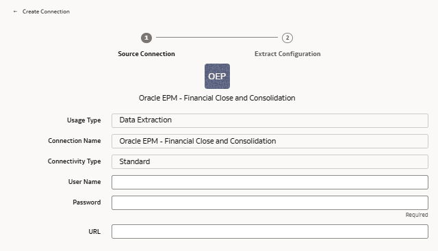

    5. In the dialog for the Oracle EPM connection, provide these details in Source Connection and then click Save and Next:
      Some properties are defined on the Extract Configuration tab. These properties are visible, but read-only on the Source Connection tab.
      • User Name and Password: Enter the credentials for your EPM source. Prefix the user name with the domain of your EPM source, such as domain.username.
      • URL: Enter the specific URL of your EPM source using the https://<DOMAIN_NAME>region.ocs.oraclecloud.com format. For example, https://epm7-test-a123456.epm.us6.oraclecloud.com. Ensure to use the https:// protocol to avoid a timeout error.
