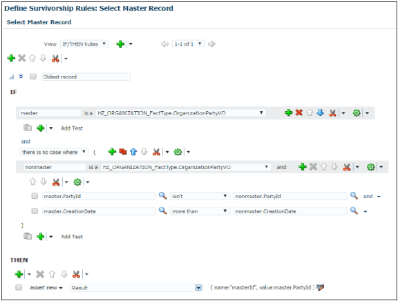

How You Set the Record with the Oldest Creation Date as Master
This rule has a single condition to set a record that has the oldest creation date as the master.
  1. Navigate to the Define Survivorship Rules: Select Master Record page.
  2. Enter the information provided in the following table as IF/THEN rules condition in the Define Survivorship Rule: Select Master Record page.
Rule Condition
Value
IF Condition
IF master is an HZ_PERSON_FactType.PersonPartyVO
and there is no case where {nonmaster == HZ_PERSON_FactType.PersonPartyVO and master.PartyId isn't nonmaster.PartyId and master.creationDate is more than nonmaster.CreationDate}
THEN Condition
THEN Assert new Result (name:"masterId", value:" master.PartyId)
The following figure displays the Define Survivorship Rules: Select Master Record page with completely filled IF and THEN rules conditions for setting a record that has the oldest creation date as the master.
Completely filled Define Survivorship Rules: Select Master Record page to set a record that has the oldest creation date as the master.

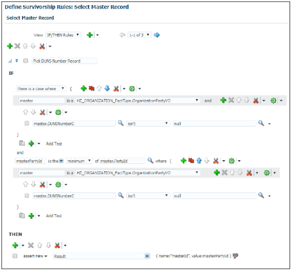

The following table lists the IF and THEN rules condition values that you must enter on the Define Survivorship Rules: Select Master Record page for this use case.
Rule Condition
Value
IF Condition
Pick D-U-N-S number{IF master is an HZ_PERSON_FactType.OrganizationPartyVO
master.DUNsNumberC isn't null}
masterPartyID is the minimum of masterPartyID
where
{master= HZ_PERSON_FactType.OrganizationPartyVO and
THEN Condition
THEN
The following figure shows the Define Survivorship Rules: Select Master Record page with IF and THEN rules conditions for picking the record with D-U-N-S number and minimum party ID as master.
Completely filled Define Survivorship Rules: Select Master Record page with IF and THEN rule conditions to pick the record with D-U-N-S number and minimum party ID as master.
Use Case 2
In this case, there is no record with D-U-N-S number. Therefore, the record with smallest party ID is picked as the master record. The following table lists the sample record information for this use case.
Record Name
Party ID
D-U-N-S Number
Master
Record 1
21
null
Yes
Record 2
22
null
No
Record 3
23
null
No

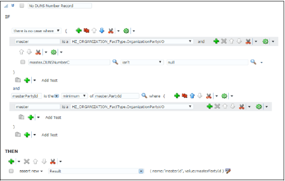

Rule Condition
Value
IF Condition
Pick D-U-N-S number
and
where
THEN Condition
THEN
The following figure displays the Define Survivorship Rules: Select Master Record page with completely filled IF and THEN rules conditions to set the record that has the smallest party ID as the master when no record with D-U-N-S number is found.
Define Survivorship Rules: Select Master Record page with the IF and THEN rule conditions to pick the record with no D-U-N-S number and minimum party ID as master.
In this example, you have created two set master rules for Organization. First rule is for the cases where the input records have at least one record with D-U-N-S number. The second is for the case where no records have D-U-N-S Number.

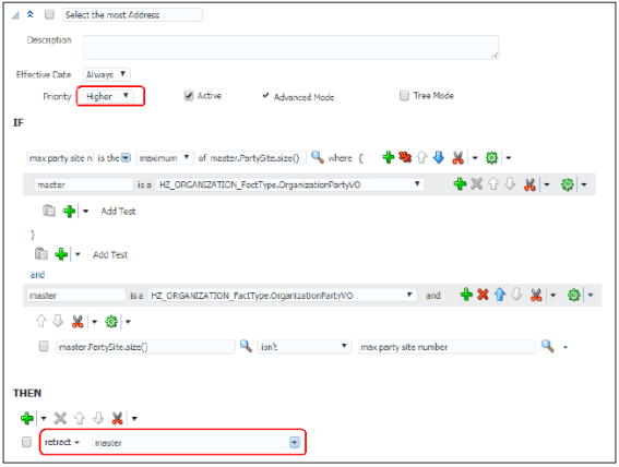

Now, you set the conditions to set the record with the maximum number of party sites as the master.
The following figure shows the Survivorship Rules: Select Master Record page with the IF and THEN condition values to set the record with the maximum number of party sites as the master from the remaining potential records. The priority of the rule is set as higher. The details of the conditions are as follows.Priority: HigherIF condition: If maximum party site number is the maximum of master.PartySite.size() where {master is a HZ_ORGANIZATION_FactType.OrganizationPartyVO} and master is a HZ_ORGANIZATION_FactType.OrganizationPartyVO and master.PartySite.size() isn't maximum party site numberTHEN condition: Then retract master
The Survivorship Rules: Select Master Record page with the IF and THEN rules condition values to set the record that has more party sites as master.

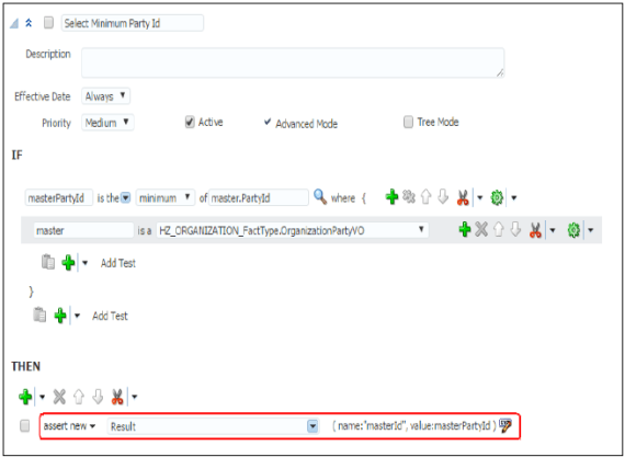

When the records are screened with two previous conditions, you create a third condition to screen all remaining potential records with the smallest party ID.
The following figure shows the Survivorship Rules: Select Master Record page with the IF and THEN condition values for creating a set master rule to set the record with the smallest party ID as the master. The priority of the rule is set as medium. The details of the conditions are as follows.Priority: MediumIF condition: If masterPartyId is the minimum of master.PartyId where {master is a HZ_ORGANIZATION_FactType.OrganizationPartyVO}THEN condition: Assert new Result(name: "masterId",value:masterPartyId)
The Survivorship Rules: Select Master Record page with the IF and THEN rules condition to set the record with the smallest party ID as the master. This condition is picked only if the first two conditions aren't met.
In this example, the rules are created to narrow down the list of potential master records. When you activate more than one rule at a time you should set the conditions for the rule according to the priority to narrow down the list of potential master records. In this example Eliminate Null D-U-N-S Number rule is executed first to select records with D-U-N-S Number. Select the Most Address rule is executed next to find the master record with most number of party sites among the potential master records having D-U-N-S Number. Finally, Select Minimum Party ID rule is executed at the end to pick the minimum party ID from the remaining party records.
