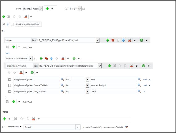

    Rule Condition
    Value
    IF Condition
    IF PersonParty is a TCHFactTypeDictionary.PersonPartyVO and there's a case where {OrigSourceSystem} != null and   OrigSourceSystem.OwnerTableId == PersonParty.PartyId and OrigSourceSystem.OrigSystem == "GSI"}
    THEN Condition
    THEN Assert new Result (name:"masterId", value:"PersonParty.PartyId)

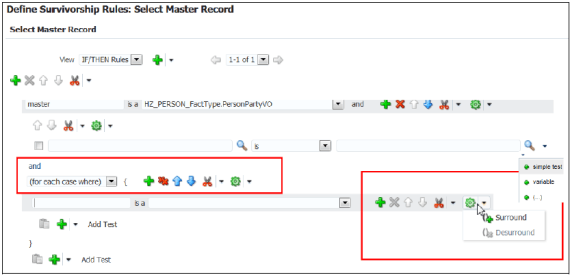

    Note the following specification in the Define Survivorship Rules: Select Master Record page.
    • Click the + icon to add additional patterns to include additional conditions
    • Click the Surround with Parenthesis option to add more features to the conditions
    • Select the + Simple Test option to add additional clauses
    The following figure shows the Define Survivorship Rules: Select Master Record page with the Surround icon highlighted.
    The Define Survivorship Rules: Select Master Record page with the Surround icon highlighted.

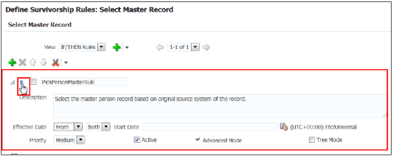

  3. Click the Advanced Settings button to verify the effective date of the rule that you're going to create.
    The following figure shows Advanced Settings icon on the Define Survivorship Rule: Select Master Record page.
    The Define Survivorship Rules: Select Master Record page with Advanced Settings icon highlighted.
  4. Select an effective date, as appropriate. The default effective date is Always. You can select an Effective From or Effective To date, or you can select an Effective Date range.
  5. Select a priority for the rule, as appropriate.
    The default priority of the Survivorship rules is Medium. These rules get executed in the order of their priority.

    The following figure shows how the survivorship rule looks like when fully defined. The details include the rule name and the IF and THEN conditions for determining the master.
    The Select Master page with fully defined select master record survivorship rule.
