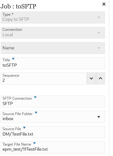

Here are sample job type parameters for a Copy to SFTP job type:
Image shows parameters for a Copy to SFTP job type.
