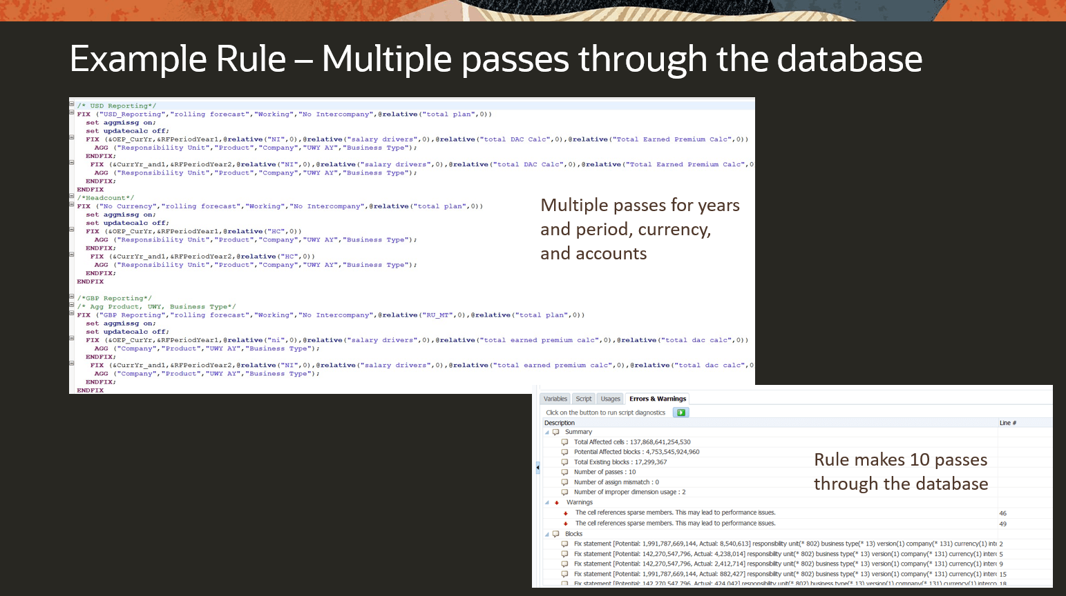

Example 1: Rule that Makes Multiple Passes Through the Database
The following rule makes 10 passes through the database for years and period, currency, and accounts.
Example Rule – Multiple passes through the database
