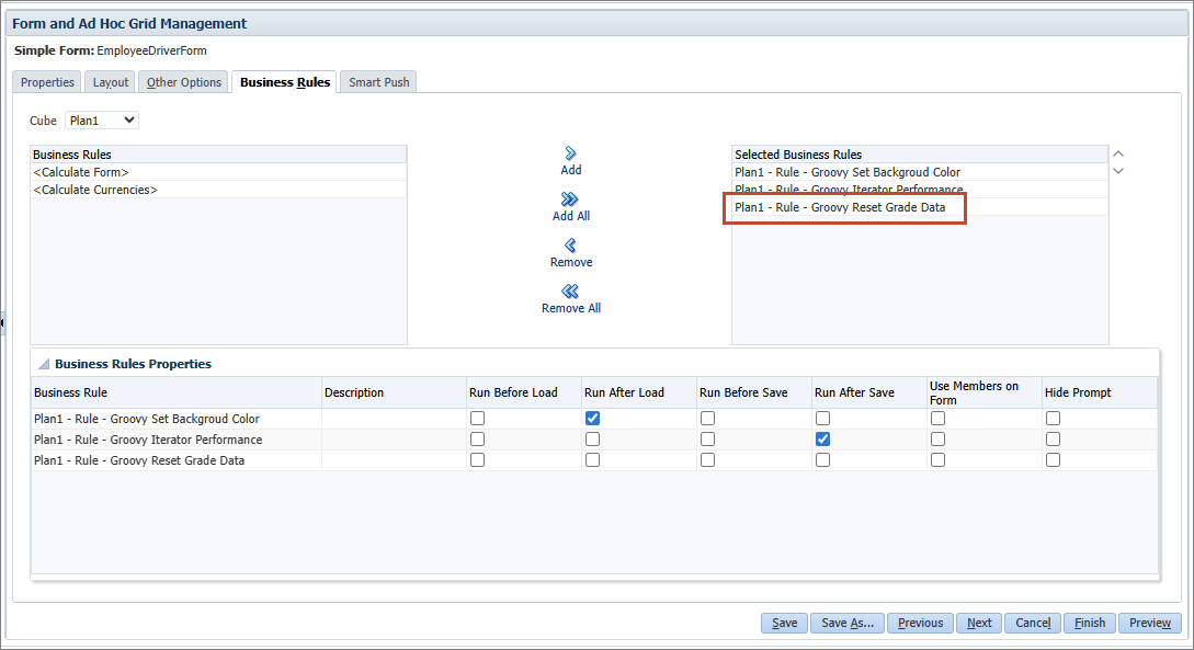

Adding the Rule to a Data Form

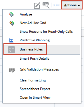

  1. In the EmployeeDriverForm form, click Actions, then select Edit.
    Actions menu with Edit selected
  2. Select the Business Rules tab, then add Groovy Iterator Performance to Selected Business Rules.
    Business Rules tab with Groovy Iterator Performance added to Selected Business Rules
  3. Under Business Rule Properties, for the Groovy Iterator Performance rule, select Run After Save.
    Groovy Iterator Performance configured to Run After Save
  4. Click Save to save the form definition. Click OK to close the information message.
    Information message confirming that the form has been saved
  5. At the bottom of the page, close the Edit EmployeeDriverForm tab to return to the data form.

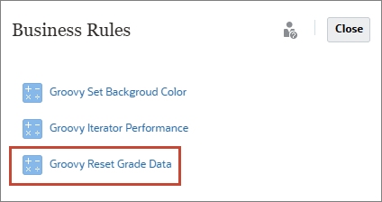

    Code reference 3 Construct a data grid by adding the POV members, column members and rows with data values. Passing currentYear to addPov keeps the reset rule aligned with the form without hard-coding a year.
    Code reference 4 Build a status object for the DataGrid object created in the next step.
    Code reference 5 Build the DataGrid object with the withCloseable construct. It closes the grid when the block completes, so the rule does not leave the grid open in memory.
    Code reference 6 Print the number of cells accepted or rejected by the builder to the job console. Any read-only cells are rejected.
    Code reference 7 Save the data grid.
  1. In EmployeeDriverForm, click Actions, then select Edit.
  2. Select the Business Rules tab.
  3. Add Groovy Reset Grade Data to Selected Business Rules.
    Business Rules tab with Groovy Reset Grade Data in Selected Business Rules
  4. Under Business Rule Properties, for the Groovy Reset Grade Data rule, leave Run Before Load, Run After Load, Run Before Save, and Run After Save cleared so that you can launch it manually.
    Groovy Reset Grade Data with all automatic load and save options cleared
  5. Click Save to save the form definition, then click OK to close the information message.
  6. At the bottom of the page, close the Edit EmployeeDriverForm tab to return to the data form.
Testing the Groovy Script
  1. Click Actions, then select Rules & Smart Push.
    Actions menu with Rules and Smart Push selected
  2. Under Rules, select Groovy Reset Grade Data to launch the rule.
    Rules list with Groovy Reset Grade Data selected
  3. When the rule completes successfully, click OK to close the information message.
    Information message confirming that Groovy Reset Grade Data ran successfully
