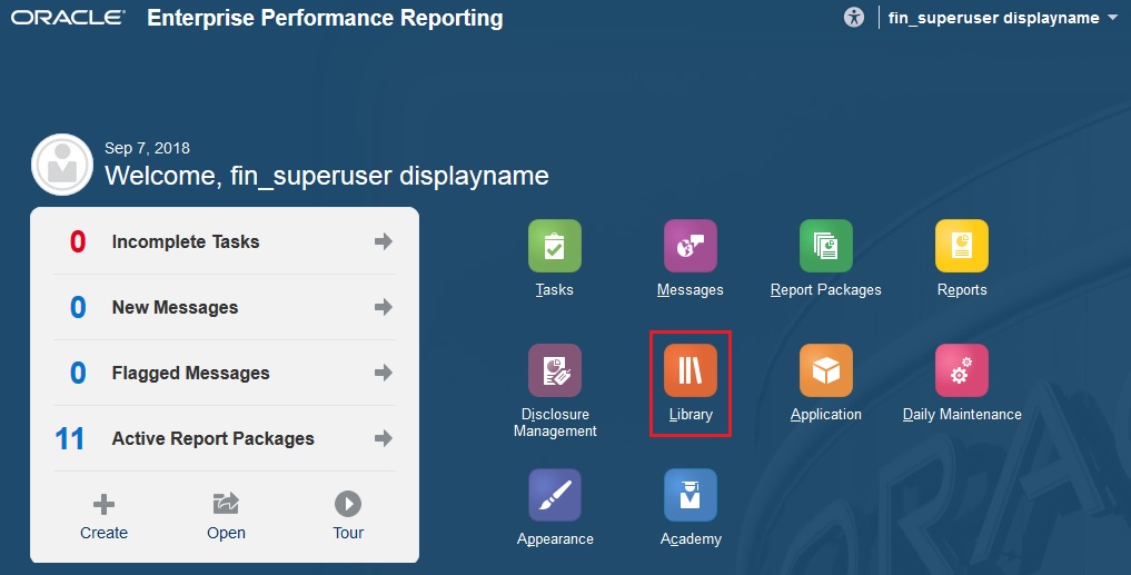

  2. From the Enterprise Performance Reporting Home page, click Library.
    Enterprise Performance Reporting Home page with the Library option selected

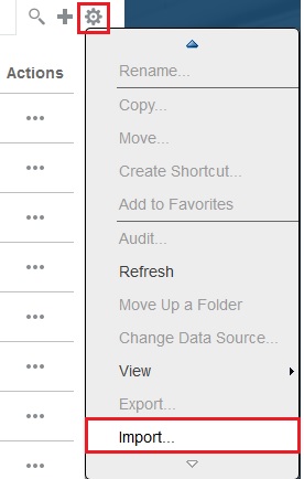

  3. Click Actions Actions button, and then select Import.
    Actions menu with the Import options selected

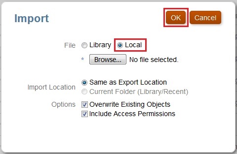

  4. In the Import dialog box, select Local, and click Browse.
    Import dialog box

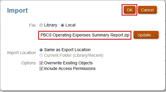

  5. Select the PBCS Operating Expenses Summary Report.zip file that you have saved to your local drive, and click Open.
  6. Click OK to begin the import process.
    Import dialog box with the zip file displayed

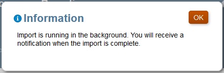

  7. Click OK in the Information dialog box.

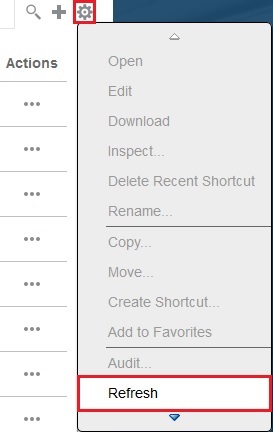

  8. Click Actions Actions button, and then select Refresh.
    Actions menu with the Refresh option selected

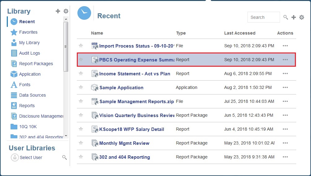

    The PBCS Operating Expense Summary Report.zip is displayed in the library.
    Sample report displayed in the library
