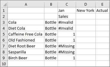

For example, suppose you create an ad hoc grid showing sales in bottles for all products in the Product dimension. For Cola and Diet Cola, bottles are not available, but bottles are available for all the other products in the Product dimension. In this case, the attribute Bottle has no association with Cola or Diet Cola.
With the Enable Attribute Association Processing option selected, cells for Cola and Diet Cola sales in bottles would display #Invalid by default, as shown in Figure 6-4. Note that you could define your own label for these cells.
Figure 6-4 Ad Hoc Grid with Enable Attribute Association Processing Selected

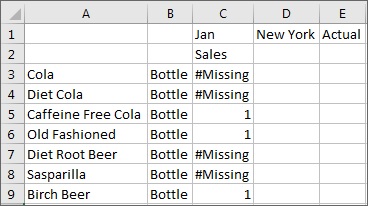

Clear the Enable Attribute Association Processing option, and cells at those same intersections, where the attribute is not associated with the base dimension, would display as #Missing, as shown in Figure 6-5. In this case, you do not know which attribute cells are actually missing data, and which attribute cells have no association with the base dimension and, therefore, would never contain data.
Figure 6-5 Ad Hoc Grid with Enable Attribute Association Processing Option Cleared
