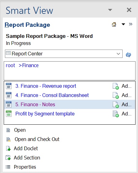

  1. In the Report Center, select the doclet to check out.
    Note the following when selecting doclets:
    • Clicking the doclet name opens the doclet, but does not check it out.
    • Clicking to the right of the doclet name allows you to select the doclet, but not open it.

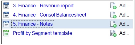

    • If you are using the keyboard to navigate the Report Center, use Ctrl-Tab to navigate to the first doclet icon in the Report Center list, then Tab to the doclet title, and then use the up and down arrow keys to navigate to the doclet to select. Use Ctrl-Tab to move to the Action Panel menu items, then use the up and down arrow keys to navigate to an Action Panel option, and then press the spacebar to select an option.
      When a doclet is selected using keyboard navigation, the selected doclet name has a dotted-line box around it:
      TBD
  2. In the Action Panel, select Open and Check Out.
    The Open and Check Out command is shown in the Action Panel after selecting a doclet in the report package.
    Selecting this option opens the doclet and checks it out in one operation.
    Alternatively, double-click the doclet name to open, then continue with step 3.
