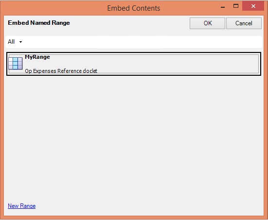

  3. In the Narrative Reporting ribbon, click the Embed button to launch the Embed Contents dialog box.
    Figure 18-30 shows one named range available for embedding, sourced from a reference doclet.
    Figure 18-30 Embed Contents Dialog Box
    The Embed Contents dialog box, showing one named range available for embedding.

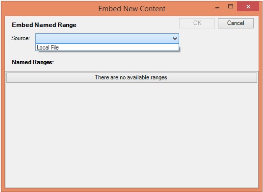

  5. In Embed New Content, click the drop-down menu in Source and select Local File, as shown in Figure 18-31.
    If you have already added content from reference files, you will see the files listed in the Source drop-down menu.
    Figure 18-31 Embed New Content Dialog Box
    The Embed New Content dialog box, showing the drop-down menu in the Source field, where you select Local File the first time you add a reference file to a doclet.

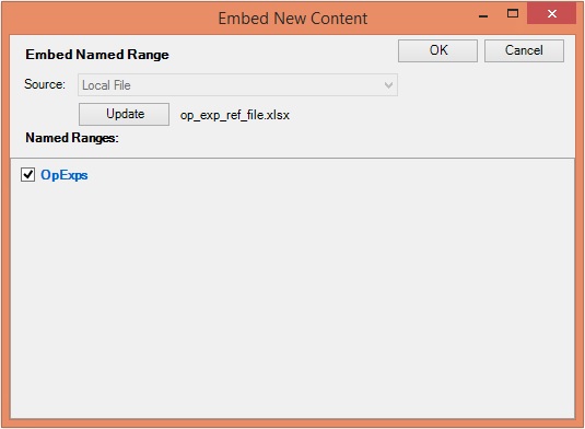

  7. In the Embed New Content dialog box, select the check box next to the named ranges that you want to add as embeddable content.
    In Figure 18-32, there was one named range in the reference file, OpExps, and this range is selected.
    Figure 18-32 Embed New Content Dialog Box with a Named Range Selected
    The Embed New Content dialog box with a named range selected.

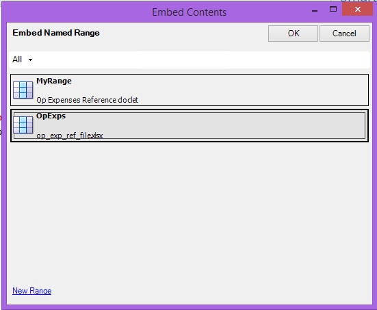

  8. Click OK to return to the Embed Contents dialog, and select the newly added range.
    Figure 18-33 Embed Contents Dialog Box, with New Range Selected
    The Embed Contents dialog box, with the newly-added range, OpExps, selected
