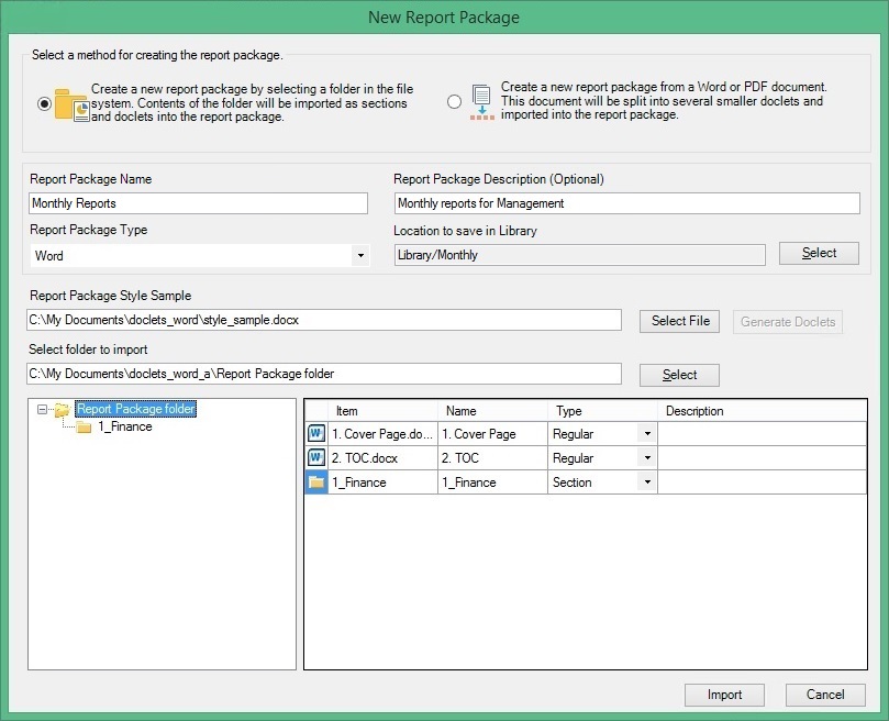

    In the bottom portion of the dialog, the folder you selected, and its subfolders, is displayed in the left pane; the doclets and sections, which will be created from the files and subfolders, are displayed in the right pane, as shown in Figure 18-9.
    Figure 18-9 Options for Creating a Report Package Structure from a Folder
    Shows the fields displayed in the New Report Package dialog when the option to create a new report package structure from a folder is selected. The available fields are: Report Package Name, optional Report Package description, Report Package Type, Location to save in Library, Report Package Style Sample, and Select folder to import. The bottom portion of the dialog contains the folder, subfolders, and files that you are importing. Here, you can edit the doclet type and add an optional description to each file.
    The example in Figure 18-9 shows the New Report Package dialog before clicking the Import button. In the example, we're using the files in the Report Package files folder to create a report package structure that will be stored in the Monthly folder in the Library.
