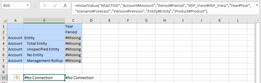

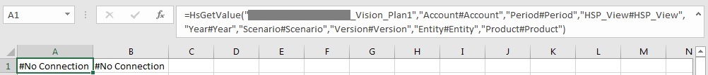

HsGetValue functions, function grids, and dynamic data points must be created using Smart View 11.1.2.5.900 or later and refreshed once to save the connection information. Otherwise, the server-initiated refresh will not be able to evaluate the functions, function grids, or data points and a
#No Connection
message will be returned.If you're not using Smart View version 11.1.2.5.900 or later, then HsGetValue functions, function grids, and dynamic data points should not be included on selected sheet.

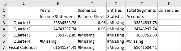

Basic Ad Hoc Grid
In the example below, the sheet contains only a basic ad hoc grid. There are no formulas, functions, pasted data points, referenced cells, or other Smart View or Excel elements on the sheet.
Supported by: EPM Cloud, Narrative Reporting

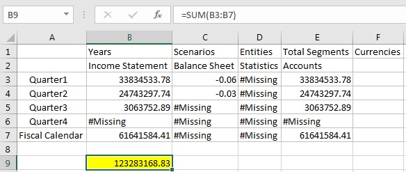

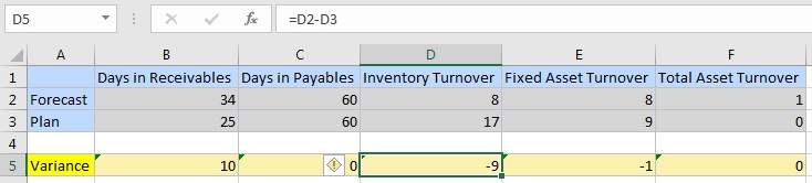

Ad Hoc Grid with Formula
You can place formula cell outside of the grid. In the example below, cell B9 contains a formula.

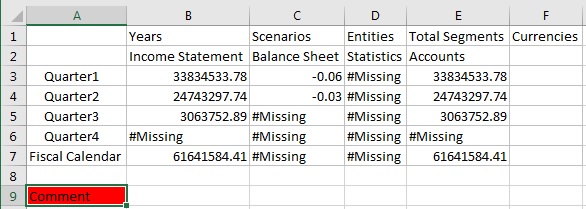

Ad Hoc Grid with Comment
You can place text comments in cells outside of the grid. In the example below, cell A9 contains a formula.

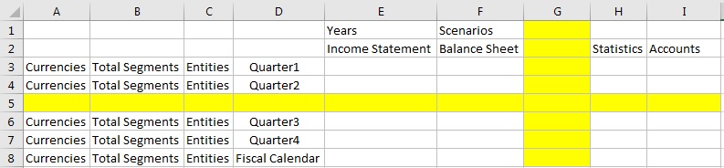

Ad Hoc Grid with Blank Rows and Columns
You may use blank rows and columns with a grid.

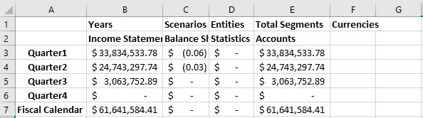

The multiple ad hoc grids on a single sheet scenario is not supported.

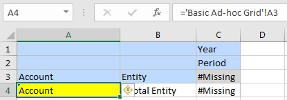

Grid with Referenced Member
This grid contains a member (cell A4) referenced as a formula from another sheet.

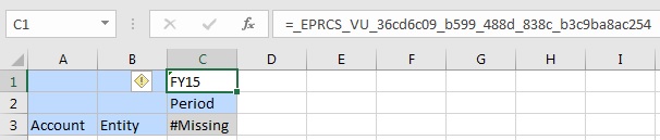

Grid with Members Referenced as Narrative Reporting Variable
This grid, based on an EPM Cloud data source, contains a member (cell C1) referenced as an Narrative Reporting variable.

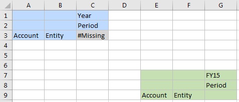

Grid Containing Pasted Data Points
This grid, based on an EPM Cloud data source, contains a cell range (cells C3 to E5) consisting of pasted data points. The data points can be copied from another sheet within the same workbook or from a different workbook. The data source for the data points could be based on the same data source as the original sheet, or a different data source.

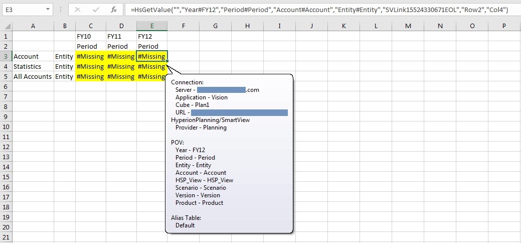

Function-Only Grid
This grid contains two functions, both based on an EPM Cloud data source. Sheets may contain functions based on different support data sources.

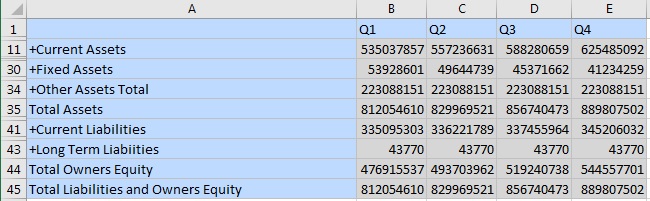

Formatted Ad Hoc Grid
