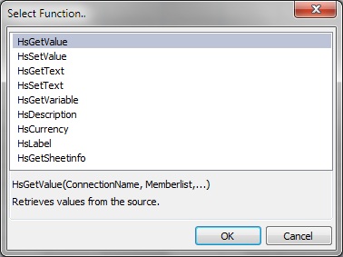

  4. In Select Function, select a function from the list and click OK.
    Figure 21-1 Function Builder, Select Function Dialog Box
    The Function Builder, Select Function dialog box, with HsGetValue, selected as described in this section
    Not all functions are available to all providers. See Table 21-1 for a list of functions and the supported providers.
