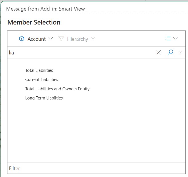

  4. Optional. To search for members in the Members list, type the required word or letters in the search box. As you type each letter, the Members list filters instantly to display the matching members. The members in the search results are displayed as a flat list, instead of the hierarchical tree view. In the below example, the letters "lia" fetches four members that match the search term.
    Member list filters to display the matching members for the partial search term
