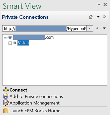

  6. To launch the Books panel, depending on the data source you are connected to, perform an action:
    • Planning, Planning Modules, Financial Consolidation and Close, Tax Reporting:
      1. In the Smart View Panel, select the application node.
      2. In the Action Panel, select Launch EPM Books Home:
        The Smart View Panel when connected to Planning, Planning Modules, Financial Consolidation and Close, or Tax Reporting; the Launch EPM Books Home command appears in the Action Panel at the bottom of the Smart View Panel

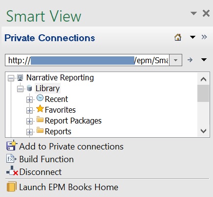

    • Narrative Reporting Library panel:
      1. In Narrative Reporting Home, click Library.
      2. In the Smart View Panel, expand the Library node or click Connect in the Action Panel.
      3. In the Action Panel, select Launch EPM Books Home:
        The Smart View Panel when connected to Narrative Reporting; the Launch EPM Books Home command appears in the Action Panel at the bottom of the Smart View Panel
