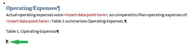

  2. Place the cursor at the point in the target doclet where the embedded content should be inserted.
    In Figure 17-21, the solid green arrow shows the insertion point for the embedded content.
    Figure 17-21 Example Target Word Doclet with Cursor at Insertion Point
    A portion of a Word doclet, showing the cursor with an arrow pointing at it. This is where the content will be embedded.
