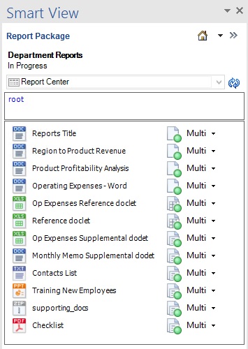

In Oracle Smart View for Office, you can only download non-Office-based supplemental doclets. To check out non-Office supplemental doclets, use the Oracle Enterprise Performance Reporting Cloud web interface.
Before you begin this procedure, you should have already launched an Office application, connected to Oracle Enterprise Performance Reporting Cloud, and opened a report package, as described in Connecting to Enterprise Performance Reporting in Smart View.
To check out a doclet, reference doclet, or supplemental doclet:
