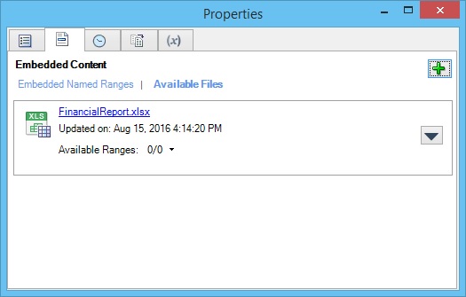

  4. In Properties , click the Embedded Content tab, Embedded Content tab, and then click the Available Files link.
  5. On Available Files, click Add button for registering a reference file to a doclet, looks like a plus sign, and then on Add Embedded Content File, click The Choose File button.

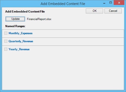

  6. Navigate to the Excel file to register as a reference file, select it, and click Open.
    The Add Embedded Content File dialog box lists the content "registered" with the doclet in order to be made available for embedding. For example, in Figure 16-20, the Excel file that was selected as a reference file contained three named ranges; therefore, these three named ranges can be registered as available content with the doclet.
    Figure 16-20 The Add Embedded Content File Dialog Box Listing Available Content Items
    The Add Embedded Content File dialog box, showing three ranges from the selected reference file can be registered as available content with the doclet.
    Remember, the available content is content that you specified as named ranges, as described in Defining Named Ranges in Reference Files.

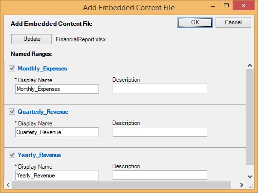

  7. Click the range names that you want to make available for embedding in the doclet.
    The check mark that appears next to the range name shows that the range is now registered with the doclet. For example, in Figure 16-21, we selected all three available ranges to register them with the doclet.
    Figure 16-21 The Add Embedded Content File Dialog Box After Registering Ranges
    The Add Embedded Content File dialog box, showing the three available ranges selected to register them with the doclet
  8. Click Close to close the Add Embedded Content File dialog box.
    You are returned to the Embedded Contents tab of the Properties dialog. The reference file is now registered with the doclet, as shown in
    Figure 16-22 Properties Dialog, Embedded Content Tab, Showing Registered Reference File
    The Properties dialog, Embedded Content tab, listing the reference file that just registered with the doclet
    Note that you can choose to embed content in the doclet at this point, from this dialog box. But this procedure is looking at registering content only. See Embedding Reference File Content in a Doclet for instructions on embedding available content from the registered reference file.
