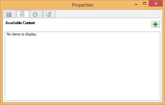

  4. Select the Available Content tab.
    Figure 17-13 Properties Dialog Box - Available Content Tab
    The Properties dialog box with the Available Content tab selected; the dialog shows no available content at this time

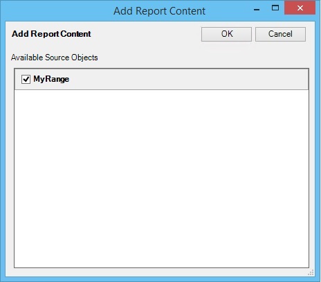

  5. Click the Add button, The Add button in the Available Content tab of the Properties dialog box, to launch the Add Report Content dialog box.
    In Add Report Content, all available content in the reference doclet is displayed.
  6. Select the check box next to the content which you want to make available for embedding later.
    For example, in Figure 17-14, the available range, "MyRange" is selected.
    Figure 17-14 Add Report Content Dialog Box
    The Add Report Content dialog box showing one range available and selected.

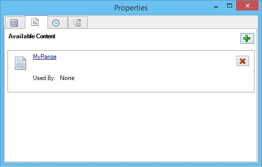

  7. Click OK to go back to the Available Content tab of the Properties dialog box.
    Figure 17-15 Properties Dialog Box - Available Content Tab with Content Added
    The Properties dialog box with the Available Content tab selected; the dialog shows that there is available content at this time
