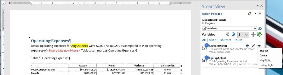

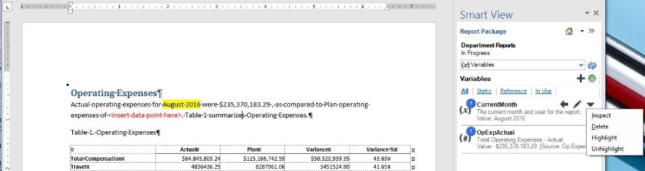

  4. Click the Options button, The Options button for a selected variable, resembles the head of an arrow pointing downward and, from the drop-down menu, select Highlight.
    In Figure 17-35, the CurrentMonth variable, a static variable, is selected in the Smart View Panel. After selecting Highlight, the CurrentMonth variable is highlighted in the doclet at the left.
    Figure 17-35 Doclet with Highlighting Enabled for a Selected Variable
    On the right, in the Smart View Panel, a selected variable is shown, along with the menu options available for that variable from the Options button. On the left, the location of the selected variable inserted in the doclet is shown with yellow highlight.
