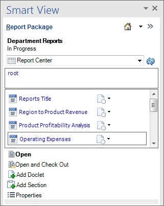

  2. In the Smart View Panel, select the doclet to check out.
    Figure 17-52 Smart View Panel Showing the Operating Expenses Doclets Selected
    Initial report package window showing the report package name and listing the doclets it contains. The doclet entitled Operating Expenses is selected

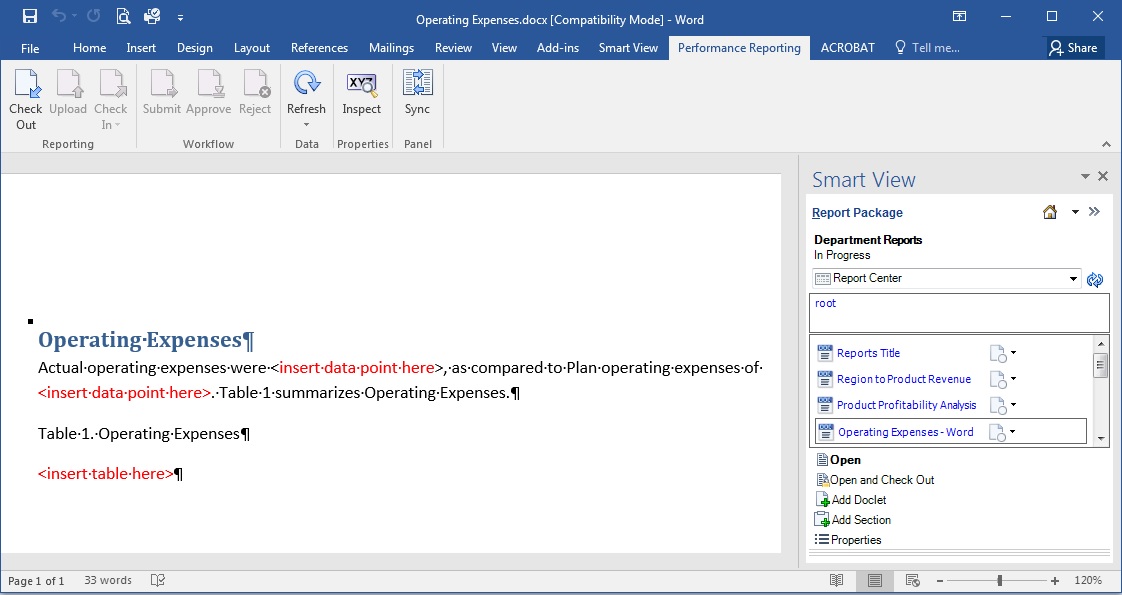

  3. Double-click the doclet name to open it.
    Figure 17-53 Doclet Opened from Smart View Panel, Ready to be Checked Out
    Shows the Word interface, at the right of the window, doclet opened on the left side
  4. In the Performance Reporting ribbon, click Check Out.
    The Check Out button in the Performance Reporting ribbon
    You can now author in the doclet. The example doclet in Figure 17-53 has placeholders within the paragraph for pasting data points. You can paste the entire grid below the table caption.

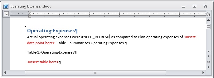

    3. In Word, position the cursor in the paragraph at the required location, and then, in the Smart View ribbon, click Paste.
      The paste operation results in a placeholder, "#NEED_REFRESH".
      The doclet showing the #NEED_REFRESH placeholder at the point where we pasted the data point
      In this scenario, a second data point for plan operating expenses is pasted into the paragraph.

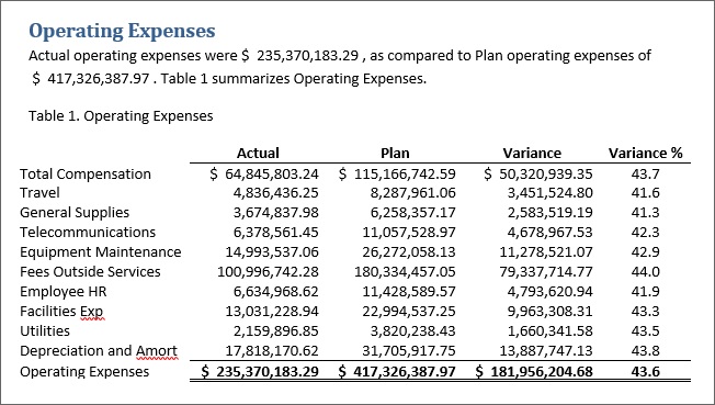

  7. Click Refresh, either in the Smart View ribbon or the Performance Reporting ribbon.
    The resulting doclet page should look like this:
    Shows the refreshed doclet page, with figures where the #NEED_REFRESH placeholders were.
  8. Use the tools in Word to format the table in the doclet.
    1. Select the entire table and from the Layout ribbon in Word, select AutoFit, and then AutoFit Contents.
    2. Center and bold the headings.
    3. Right-align all the data values in the Actual, Plan, and Variance columns.
    4. Center the percentages in the Variance % column.
    5. Bold the totals in the Operating Expenses row.
    6. Clear the borders from the entire table.
    7. Add a single underline under the column headings and under the Actual, Plan, Variance, and Variance % columns in the "Depreciation and Amort" row.
    8. Add double underlines under the Actual, Plan, Variance, and Variance % columns in the "Operating Expenses" row.
    After you've applied the Word formatting, the table should resemble the table in Figure 17-56.
