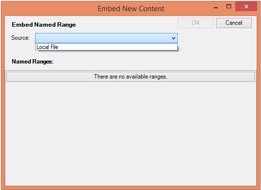

  4. Click New Range to launch the Embed New Content dialog box.
  5. In Embed New Content, click the drop-down menu in Source and select Local File, as shown in Figure 16-27.
    If you have already added content from reference files, you will see the files listed in the Source drop-down menu.
    Figure 16-27 Embed New Content Dialog Box
    The Embed New Content dialog box, showing the drop-down menu in the Source field, where you select Local File the first time you add a reference file to a doclet.

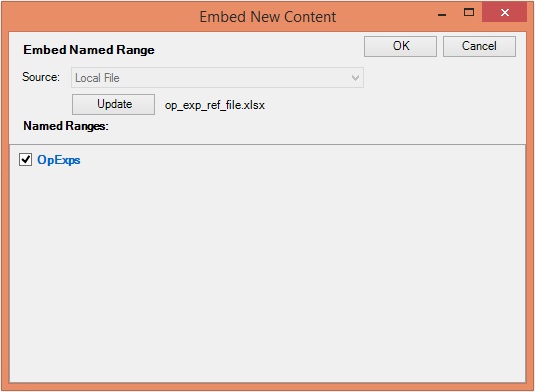

  7. In the Embed New Content dialog box, select the check box next to the named ranges that you want to add as embeddable content.
    In Figure 16-28, there was one named range in the reference file, OpExps, and this range is selected.
    Figure 16-28 Embed New Content Dialog Box with a Named Range Selected
    The Embed New Content dialog box with a named range selected.
