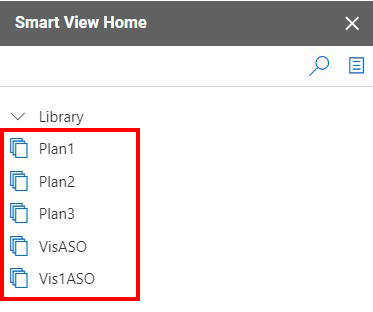

In the following example for Cloud EPM, there are five cubes from which you can select (Plan1, Plan2, Plan3, VisASO, and Vis1ASO).
Cubes displayed in the Smart View Home panel with Plan1 cube selected.
The cube data is placed on a grid in ad hoc mode, and you can start performing ad hoc analysis.

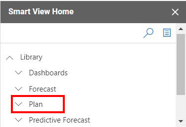

    1. Select Library.
    2. Select Plan to display all the Cloud EPM forms saved under the Plan folder.

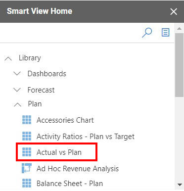

    3. Select a Cloud EPM form; for example, you could select the Actual vs Plan form.
      Smart View panel with the Actual vs Plan Planning form selected
    When you select a Cloud EPM form, the data for that form is placed on the grid; however, it is not initially in ad hoc mode.
