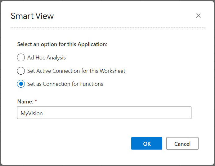

  3. Right-click the cube, select Set as Connection for Functions, type a name for the connection, and then click OK.
    In the below example, the connection name is MyVision.
    Figure 13-1 Connection Name
    Set as Connection for Functions dialog displaying the Name field where you enter the connection name to use for functions
    You must create a connection name for each new spreadsheet.
    The connection name is saved with the spreadsheet. When you reopen the saved spreadsheet, you will not be prompted to enter a connection name.

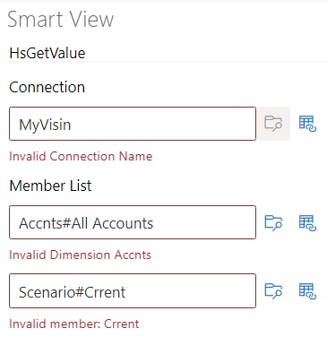

    For example, Function Builder Validation Errors shows simple spelling errors that resulted in an invalid Connection name, an invalid dimension name in one argument, and an invalid member name in another argument.
    Figure 13-5 Function Builder Validation Errors
    Spelling errors in the Connection name, a dimension name, and a member name resulting in an inline message next indicating the issue.
    Validate only works with dimension#member combinations that are hand-typed into the text boxes and does not apply to those dimension#members that are added using the Member Selector dialog. If all dimension#member combinations are entered using the Member Selector, then no validation messages regarding those combinations are displayed. You may still see an error regarding the connection name if it is misspelled.
    • If the connection name is correct and all the other dimension#member combinations were added using the Member Selector dialog, then a "Validation successful" message will not display.
    • If the connection name is correct and one or more dimension#member combinations were hand-typed correctly, then a "Validation successful" message will display.
