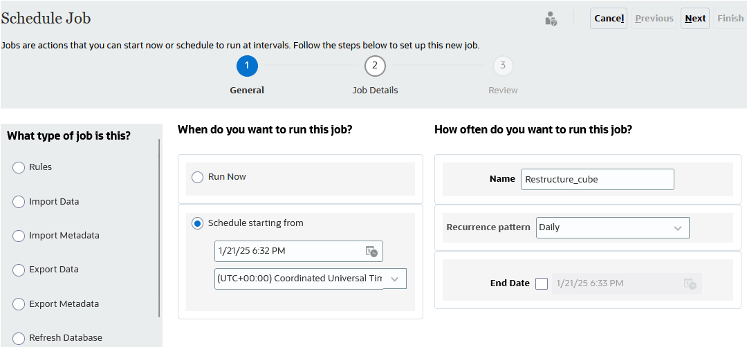

To restructure a cube:
  1. Sign in to Tax Reporting as a Service Administrator.
  2. On the Home page, click Application and then Jobs.
  3. Schedule and run the Restructure Cube job right away. Alternatively, you can schedule the job to start at a later time.
    1. a. Click Schedule Jobs.
      Schedule Restructure Job Details
    2. From What type of job is this?, select Restructure Cube.
    3. Select Run Now to start the restructuring immediately. Click Next, and then Finish. Alternatively, you can schedule the job to start at a later time.
