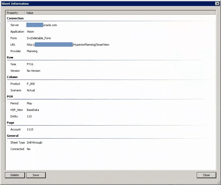

Use the Sheet Info command in the Smart View ribbon to view details about the cell intersection and POV of the cell from which the drill-through report was launched.

  3. Select the Smart View ribbon, and then select Sheet Info.
    The POV of the intersection of the drill-through launch cell is shown in the Sheet Information dialog box. In the example POV shown in Figure 5-26, we see these information categories related to the cell intersection:
    • Row members
    • Column members
    • POV members
    • Page members
    We also see a General section showing that we we're working with a drill-through sheet.
    Figure 5-26 Sheet Information Dialog Showing POV for Drill-Through Launch Cell
    Sheet Information dialog box containing information about the cell intersection from which the drill-through sheet originated.
    In Oracle Smart View for Office ad hoc mode, when drill-through is launched, the POV section of Sheet Information dialog shows the member names corresponding to the alias table selected on the ad hoc sheet.
  4. Optional: Click Save to save the POV information in a separate sheet in the workbook.
