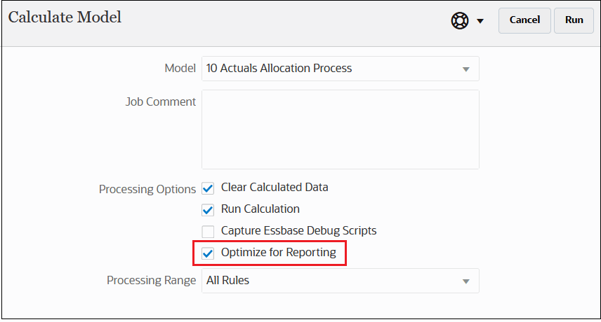

  1. From the Home page, select Modeling, and then Calculation Control.
  2. Select a point of view, and then click Calculate.
  3. In the Calculate Model dialog box, select Optimize for Reporting.
    Calculate Model dialog box with the Optimize for Reporting option selected
In most cases, the Optimize for Reporting option is sufficient for your aggregation needs.
