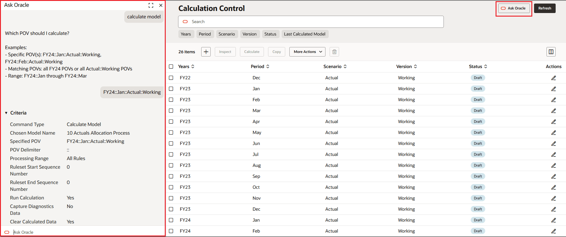

PCM Agent is embedded in the Calculation Control page, where you can enter prompts to calculate a model. It provides a true converstional experience where you are able to interact naturally with the assistant within the current workflow.
To open PCM Agent and calculate a model:
  1. Click Ask Oracle icon at the top of the Calculation Control page.
    PCM Agent is displayed on the left side of the page.
  2. Enter a calculate model prompt in the Ask Oracle area at the bottom of the page.
    The PCM Agent assistant prompts you with the information required to calculate the model.
Figure 15-1 Sample Prompts to Calculate a Model
Calculation Control page with PCM Agent displayed
