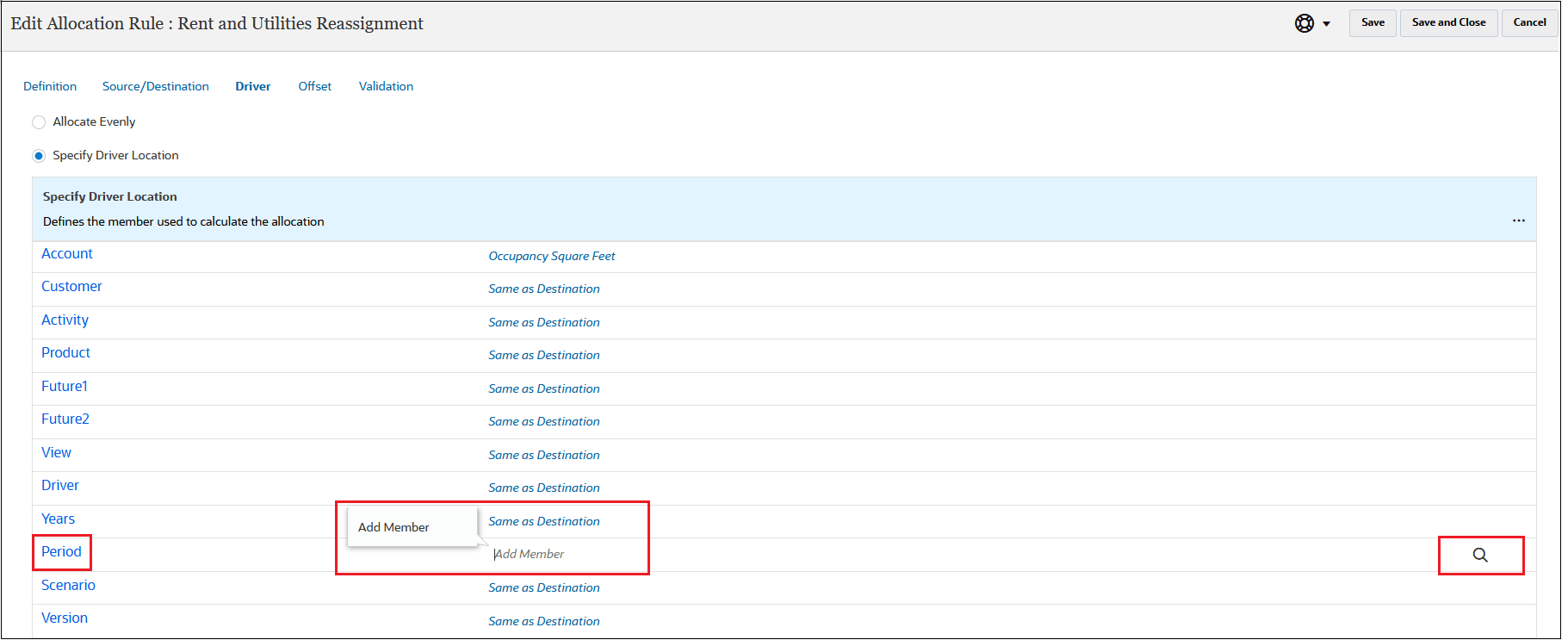

  1. Click Same As Destination next to the Period dimension, and then click Invoke Member Selector icon to open the Member Selector.
    Edit Allocation Rule page with the Period dimension selected to add a member

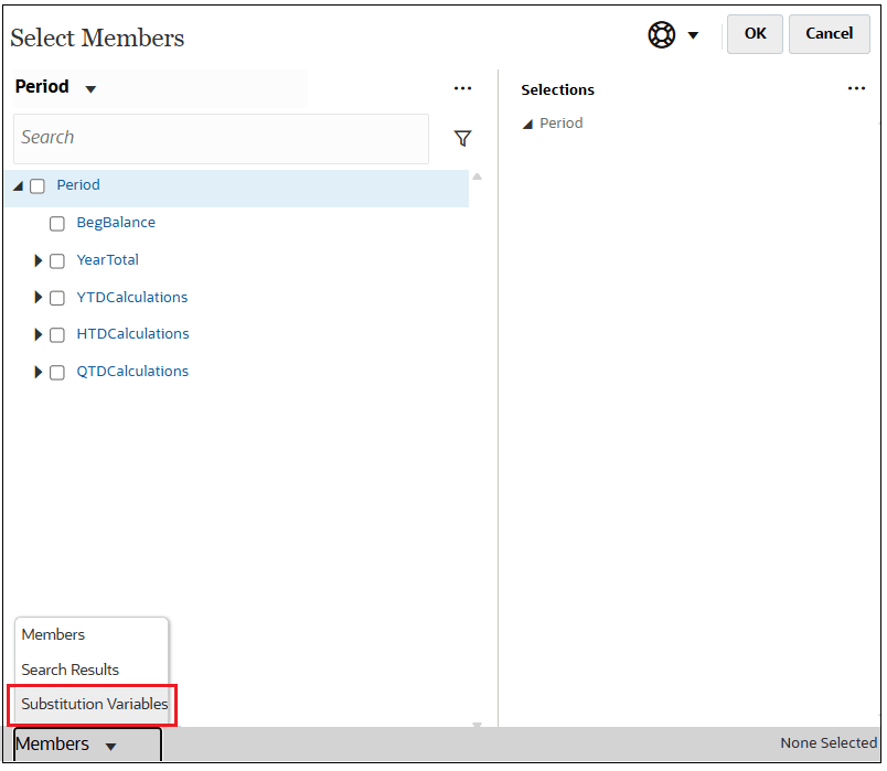

  2. Click Members at the bottom of the Member Selector, and select Substitution Variables.
    Member Selection with Substitution Variables selected in the Member drop-down

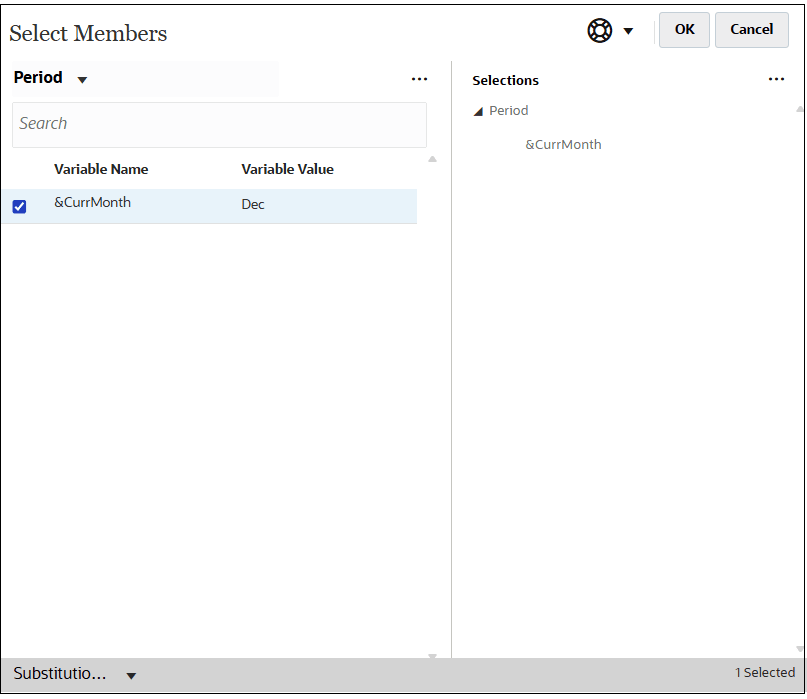

    The substitution variables that have been defined for Period are displayed. In this example, one substitution variable, $CurrMonth, has been defined. Select the substitution variable, and click OK.
    Member Selector with the $CurrMonth substitution variable selected

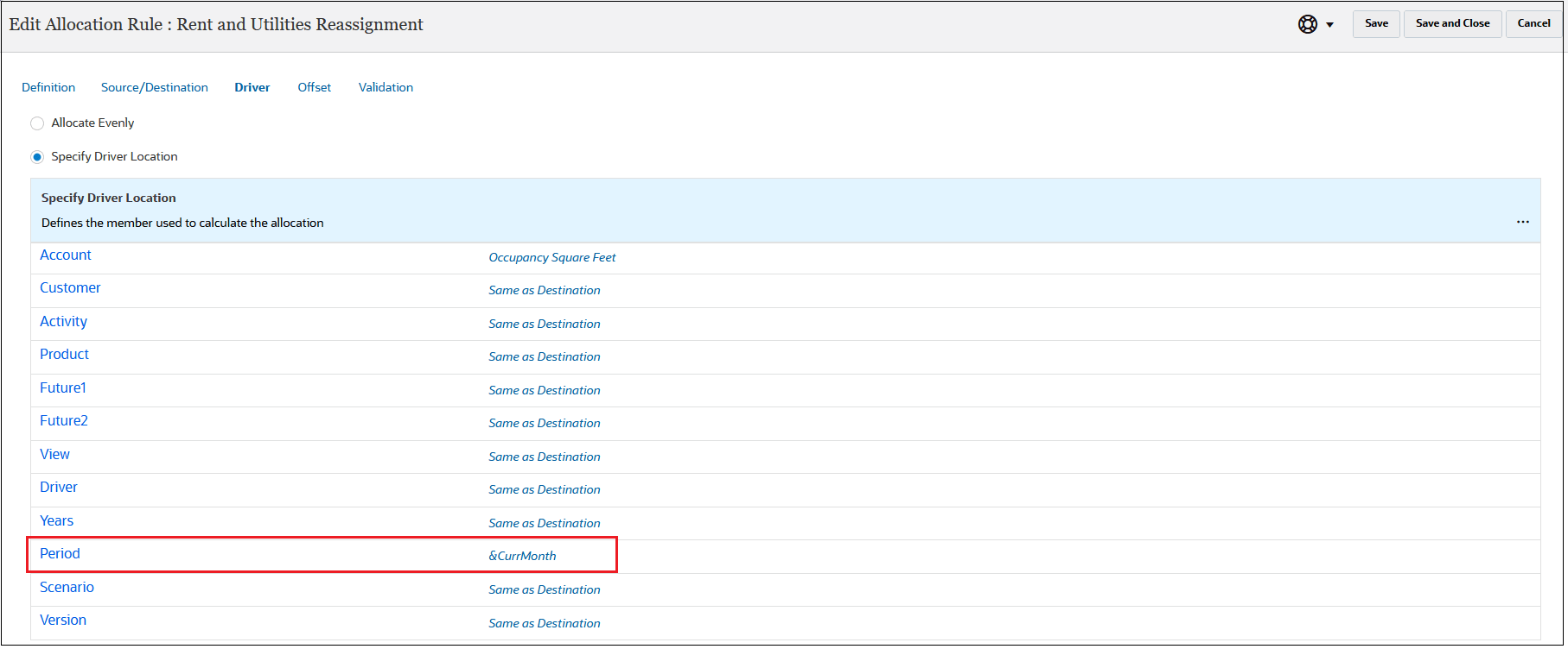

    After you select the $CurrMonth substitution variable, it is displayed as the value for the Period dimension in the allocation rule Driver tab.
    $CurrMonth displayed as the substitution variable to be used in the Period dimension

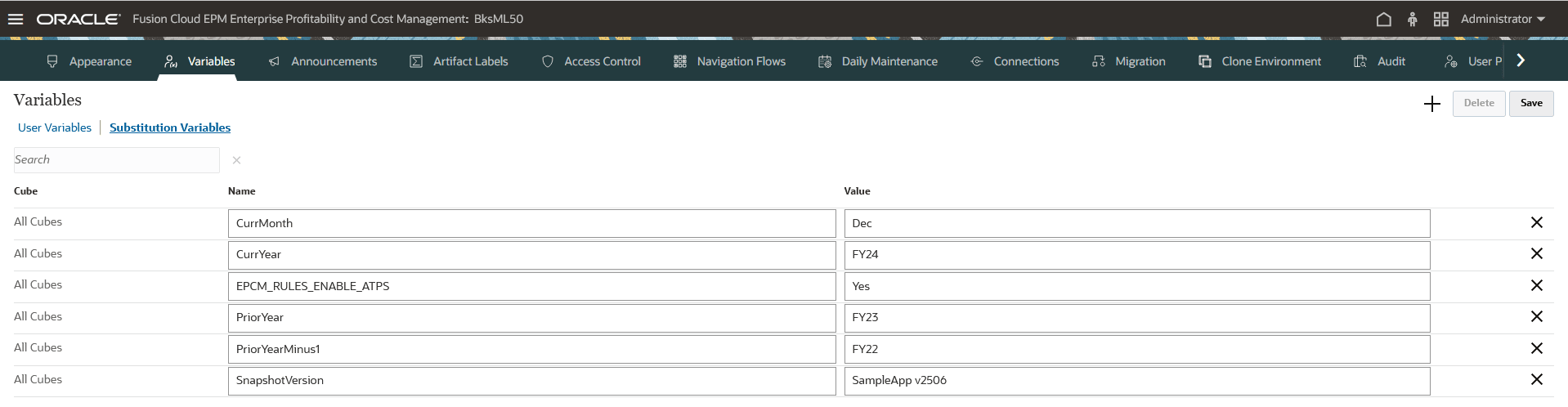

To define substitution variables:
  1. From the Home screen, select Tools and then Variables.
  2. On the Variables page, click Substitution Variables.
    Substitution Variables tab
