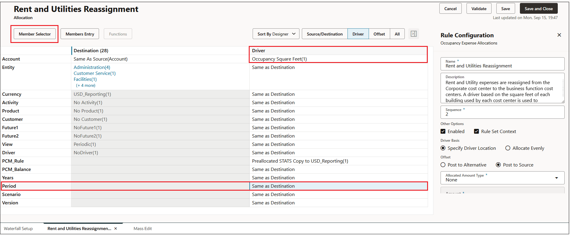

  1. On the Driver tab, click Same As Destination next to the Period dimension, and then click Edit.
    Driver tab showing Occupancy Square Feet as the driver and Same as Destination selected for the Period dimension

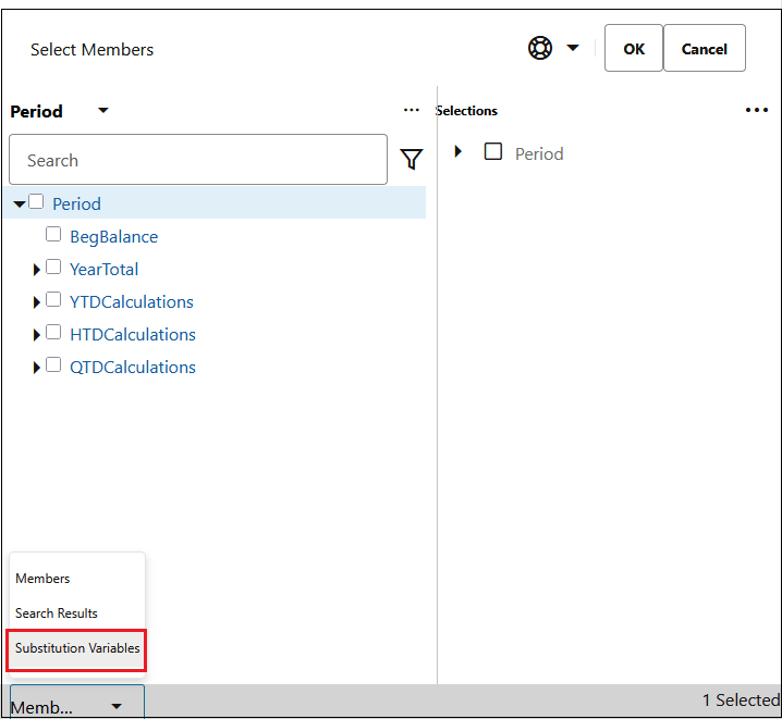

  3. Click Members at the bottom of the Select Members dialog box, and select Substitution Variables.
    Member Selection with Substitution Variables selected in the Member drop-down

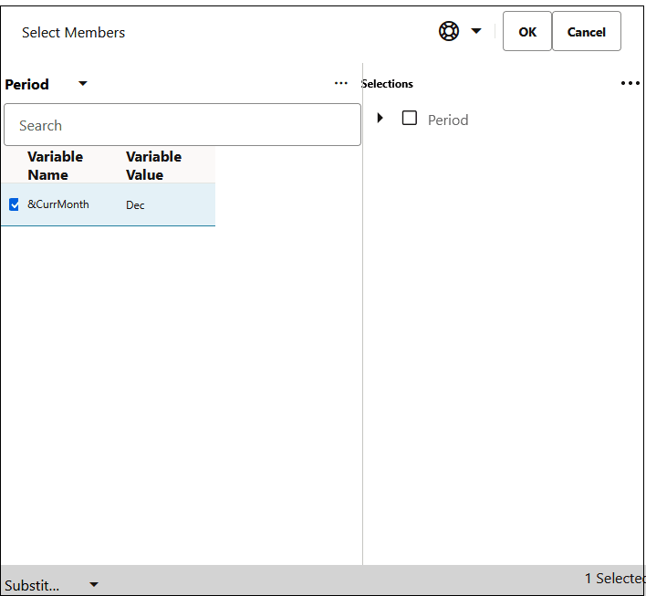

    The substitution variables that have been defined for Period are displayed. In this example, one substitution variable, $CurrMonth, has been defined. Select the substitution variable, and click OK.
    Select Members dialog box with the $CurrMonth substitution variable selected

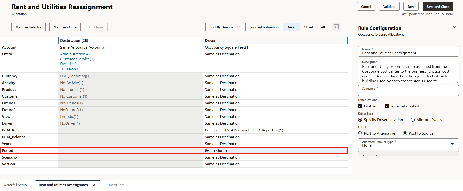

    After you select the $CurrMonth substitution variable, it is displayed as the value for the Period dimension in the allocation rule Driver tab.
    $CurrMonth displayed as the substitution variable to be used in the Period dimension
