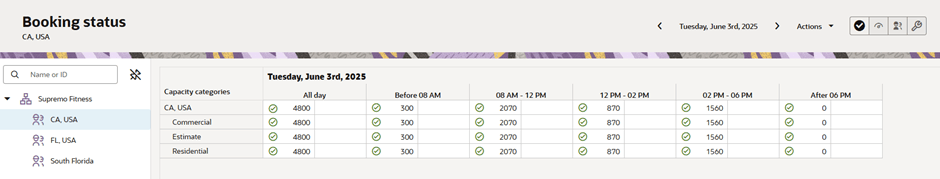

Manage Activity Booking Status
The Booking Status page lets you manage activity booking for a specific category and close quota at a particular time and for a specific work zone.
The time-slot based booking status information displays on the left-hand side of the page and the time-interval based booking information displays on the right-hand side of the page.
To view the Booking Status icon:
  1. Select Quota.
  2. Select a capacity area from the left-hand pane.
  3. Click the Booking status Click to view Booking Status icon.
    The Booking Status page displays the time slot-based booking status only if the time-slot based quota is enabled for the bucket. For the time interval based booking, all capacity categories are always displayed.
    Figure showing Booking Status page that lets you manage activity booking
