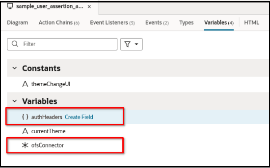

  3. Within your newly created VBCS application, navigate to the Variables section.
    1. Create the necessary variables that your application will use during its operation. The specific variables required will depend on the logic of your plugin. Use the following code to add the required variables:
"variables": {
    "authHeaders": {
      "type": "object"
    "ofsConnector": {
      "type": "any"
This screenshot shows sample variables

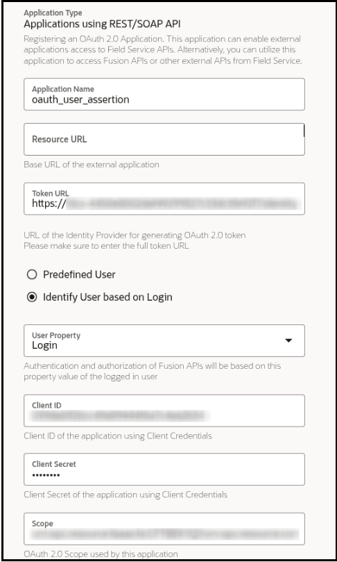

Configure IDCS and Oracle Fusion Field Service Applications
Ensure that you use the credentials of the IDCS application to configure Oracle Fusion Field Service with Oauth User Assertion for authorization as shown below.
This screenshot shows sample oauth user assertion application
