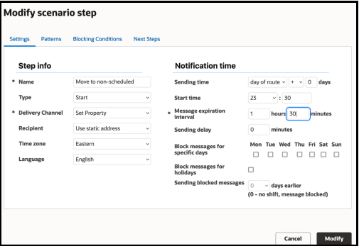

  4. In the Scenario Steps section, click the Add New link to add the step that will set pending activities to non-scheduled. The Settings tab opens by default.
    1. Enter a name for the step, for example, Move to non-scheduled.
    2. Select Start in the Type drop-down list.
    3. Select Set Property in the Delivery Channel drop-down list.
    4. Select Use static address in the Recipient field, and then specify the time zone that is set for Overnight Work on the Business Rules screen.
    5. Select day of route for Sending time and leave the days setting at 0.
    6. Define the time in the Start time field at 10:30 p.m., with a Message expiration interval value of 1 hour and 30 minutes. Leave the rest of the settings at their defaults.
      Note: You might consider setting the from time to even closer to the end of the day but be sure there’s enough time to accommodate processing in case there are many activities still in Pending status at that time.
      This screenshot displays the modify scenario step.
