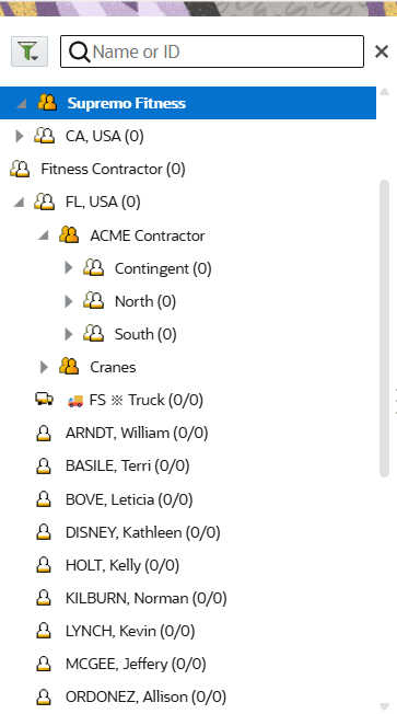

You can manage quota for a:
  • Region: Create a group for all the resources of a specific region and then create a bucket inside that group to use it for the quota management.
  • Workforce: Create a single bucket for the entire workforce and then divide the workforce into various groups within the bucket.
The bucket structure looks like this:
Bucket structure
Quota of a group or a bucket with the “child” capacity areas display the sum of quota of all the child buckets. You can't edit quota at the aggregate level.
