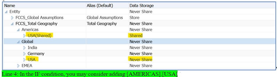

Calc Manager Script Validation for Missing Shared Entity Member References In IF Condition
When defining a shared entity in IF conditions in Configurable Calculations (insertion rules) or On-Demand rules, make sure to include both the primary entity and all its shared members, if your intention is to apply the condition to all of them.
When only the primary entity is added in the condition, the system does not automatically include the shared members unless you specify them.
A warning will be displayed for these conditions:
  • The IF condition uses the @ISMBR function to check for specific entity members
  • The member used in the condition belongs to the Entity dimension and has shared instances
  • The IF block should not include the FCCS_Parent Input member in any expression
  • Not all shared members are included along with the primary entity
This check is meant to help avoid unexpected behavior where your logic applies only to the primary entity but unintentionally skips the shared ones.
If your rule is meant to apply to only the primary or specific shared members, you can safely ignore this warning. Otherwise,update the IF condition to include all required members.
SET HYBRIDBSOINCALCSCRIPT FULL;
Fix ("FCCS_No Data Source", "FCCS_No Movement","FCCS_Local GAAP","FCCS_No Intercompany","FCCS_Periodic",)
 "Cash" (
    IF(@ISMBR("[Global].[USA]"))
     "Cash" = "FCCS_Mvmts_Total"->"FCCS_Managed Data"->"FCCS_Intercompany Top"->"FCCS_Entity Total";
       ENDIF
			   ENDFIX
For the above script, a warning will be displayed to add the missing shared entities, as USA is shared in two places but mentioned only for Global, as shown in this example.
Calc script warning for shared entities
For the Shared Entities warning use case, Financial Consolidation and Close limits the value to display only 10 shared entities per entity, to avoid overwhelming the output and to keep the message concise.
