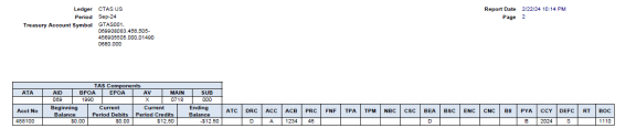

On successful completion, the process generates the GTAS Trial Balance Report. Review the trial balance data in the report by clicking the output name link in the Output & Delivery section of the Process Details tab for the process.GTAS Trial Balance Report
The GTAS Trial Balance report includes USSGL balances at the GTAS attribute level of detail. The report displays trial balance data including the beginning balance, ending balance, and the debits and credits for the reporting period.
Here's an example of the GTAS Trial Balance Report generated using sample data:
