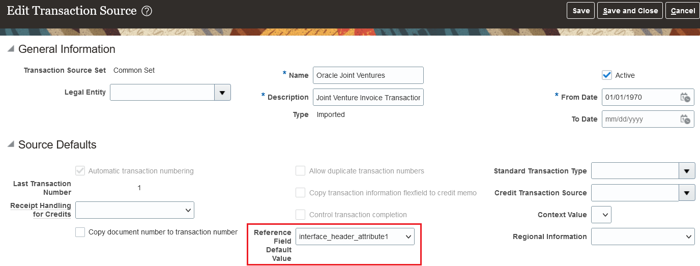

  5. On Edit Transaction Source, click the drop-down list for Reference Field Default Value and select “interface_header_attribute_1” as shown in the following image.
    You select this value to populate the cross reference value on joint venture invoices to the associated credit memos. This image shows the Edit Transaction Source page for Oracle Joint Ventures transaction source. The Reference Field Default Value is populated with the value interface_header_attribute_1.
